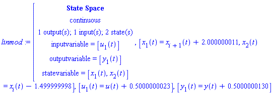

I am in need of help with Maple Linearize and an exremely crypitc and most un-helpful error message. What does this mean:
> linmod := Linearize(syss, parm, linp);
Error, invalid input: Linearize uses a 4th argument, linpoint (of type {list(`=`), set(`=`)}), which is missing
I can find nothing in the help in this.
Linearize works fine when running a sample program from the help files, but fails when I run my equations.
