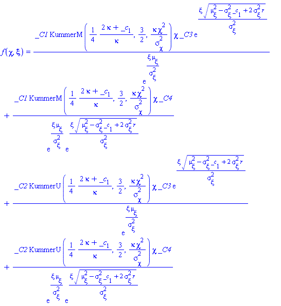

Maple gives me the complete solution to the attached PDE. This solution is expressed in terms of KummerU and KummerM. What I want is to obtain the solution for real numbers only, i.e. I want to get rid of the possible imaginary numbers in the solution. This implies that the separation constant, _c1, must be less or equal to 2r.
How can I do this?
Furthermore, the four arbitrary constants will need to be determined through boundary conditions. Is the separation constant, _c1, also determined by boundary conditions?
Any ideas are welcome!
pde := (1/2)*sigma[xi]^2*(diff(f(chi, xi), xi, xi))+(1/2)*sigma[chi]^2*(diff(f(chi, xi), chi, chi))+mu[xi]*(diff(f(chi, xi), xi))-kappa*chi*(diff(f(chi, xi), chi))-r*f(chi, xi) = 0
(1/2)*sigma[xi]^2*(diff(diff(f(chi, xi), xi), xi))+(1/2)*sigma[chi]^2*(diff(diff(f(chi, xi), chi), chi))+mu[xi]*(diff(f(chi, xi), xi))-kappa*chi*(diff(f(chi, xi), chi))-r*f(chi, xi) = 0
pdesolution := pdsolve(pde, build)
f(chi, xi) = _C1*KummerM((1/4)*(2*kappa+_c[1])/kappa, 3/2, kappa*chi^2/sigma[chi]^2)*chi*_C3*exp(xi*(mu[xi]^2-sigma[xi]^2*_c[1]+2*sigma[xi]^2*r)^(1/2)/sigma[xi]^2)/exp(xi*mu[xi]/sigma[xi]^2)+_C1*KummerM((1/4)*(2*kappa+_c[1])/kappa, 3/2, kappa*chi^2/sigma[chi]^2)*chi*_C4/(exp(xi*mu[xi]/sigma[xi]^2)*exp(xi*(mu[xi]^2-sigma[xi]^2*_c[1]+2*sigma[xi]^2*r)^(1/2)/sigma[xi]^2))+_C2*KummerU((1/4)*(2*kappa+_c[1])/kappa, 3/2, kappa*chi^2/sigma[chi]^2)*chi*_C3*exp(xi*(mu[xi]^2-sigma[xi]^2*_c[1]+2*sigma[xi]^2*r)^(1/2)/sigma[xi]^2)/exp(xi*mu[xi]/sigma[xi]^2)+_C2*KummerU((1/4)*(2*kappa+_c[1])/kappa, 3/2, kappa*chi^2/sigma[chi]^2)*chi*_C4/(exp(xi*mu[xi]/sigma[xi]^2)*exp(xi*(mu[xi]^2-sigma[xi]^2*_c[1]+2*sigma[xi]^2*r)^(1/2)/sigma[xi]^2))
