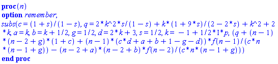

I have constructed 2 procedures:
f(n) and h(n) which i build inside a double sum but when trying to calculate it says to many levels of recursion.
but when doing a simple example it works.
so the question is basically: why cant one put functions defined by proc within a sum??

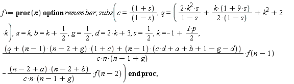

f := proc (n) option remember; subs(c = (1+s)/(1-s), q = 2*k^2*s/(1-s)+k*(1+9*s)/(2-2*s)+k^2+2*k, a = k, b = k+1/2, g = 1/2, d = 2*k+3, s = 1/2, k = -1+((1/2)*I)*p, (q+(n-1)*(n-2+g)*(1+c)+(n-1)*(c*d+a+b+1-g-d))*f(n-1)/(c*n*(n-1+g))-(n-2+a)*(n-2+b)*f(n-2)/(c*n*(n-1+g))) end proc;
f(-1) := 0
f(0) := 1

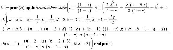

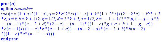

h := proc (n) option remember; subs(c = (1+s)/(1-s), q = 2*k^2*s/(1-s)+k*(1+9*s)/(2-2*s)+k^2+2*k, a = k, b = k+1/2, g = 1/2, d = 2*k+3, s = 1/2, k = -1+((1/2)*I)*p, (-q+a*b+(n-1)*(n-2+d)*(2-c)+(n-1)*((1-c)*g+a+b+1-g-d))*h(n-1)/((1-c)*n*(n-1+d))-(n-2+a)*(n-2+b)*h(n-2)/((1-c)*n*(n-1+d))) end proc;
h(-1) := 0
h(0) := 1
1

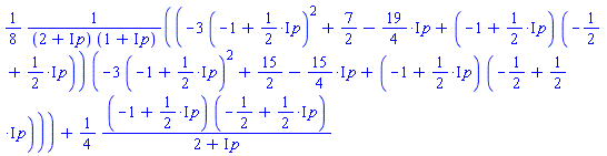

h(2)
(1/8)*(-3*(-1+((1/2)*I)*p)^2+7/2-((19/4)*I)*p+(-1+((1/2)*I)*p)*(-1/2+((1/2)*I)*p))*(-3*(-1+((1/2)*I)*p)^2+15/2-((15/4)*I)*p+(-1+((1/2)*I)*p)*(-1/2+((1/2)*I)*p))/((2+I*p)*(1+I*p))+(1/4)*(-1+((1/2)*I)*p)*(-1/2+((1/2)*I)*p)/(2+I*p)

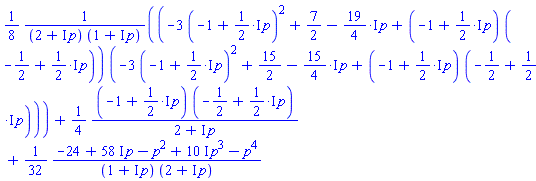

h(2)+(1/32)*(-24+(58*I)*p-p^2+(10*I)*p^3-p^4)/((1+I*p)*(2+I*p))
(1/8)*(-3*(-1+((1/2)*I)*p)^2+7/2-((19/4)*I)*p+(-1+((1/2)*I)*p)*(-1/2+((1/2)*I)*p))*(-3*(-1+((1/2)*I)*p)^2+15/2-((15/4)*I)*p+(-1+((1/2)*I)*p)*(-1/2+((1/2)*I)*p))/((2+I*p)*(1+I*p))+(1/4)*(-1+((1/2)*I)*p)*(-1/2+((1/2)*I)*p)/(2+I*p)+(1/32)*(-24+(58*I)*p-p^2+(10*I)*p^3-p^4)/((1+I*p)*(2+I*p))
simplify(%)
