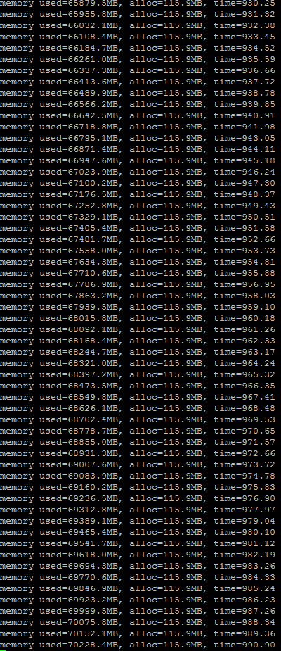

For research purposes, I have symbolic matrices of dimentions up to 100 x 50 (and above) with certain number of parameters. Then giving random value to those paramters, I want the numerical rank of the matrices.
Maple 17 does not seem to work well with symbolic ranks, where expentials are involved.
And more to it, both
Student[MultivariateCalculus][Jacobian]
and
VectorCalculus[Jacobian]
does not seem to work. (Initially, the symbolic matrices are formed from the Jacobian of a symbolic Vector)

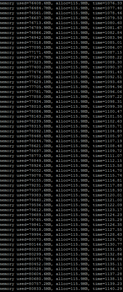

Lastly, when I put the initial values into the matrices, the Rank( from LinearAlgebra) does not work. (or work really slow).
For substitutions, I have tried both subs() and eval(), evalf(). Many ways to 'simplify' the entries.
In short, I have complex Vectors (also with exponentials) with lots of parameters.
Ideally, I want the symbolic Rank of their Jacobian matrix.
If not possible, I will give the parameters random values, but still, if seems slow, sometimes impossible to get a numerical rank.
