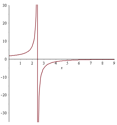

E=0   f(E)=1.8  = 1/A+1    A=-0.444    kt is unknown. Hence I try many numbers.
This is my code
plot(1/(-0.444*exp(x/3)+1),x=0..9);
I have a problem.  A is negative. The denominator would be zero.

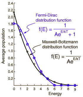

This is the theory.
http://hyperphysics.phy-astr.gsu.edu/hbase/quantum/disfdx.html#c2
