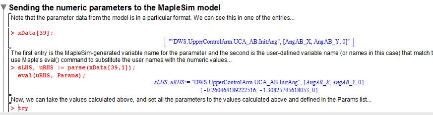

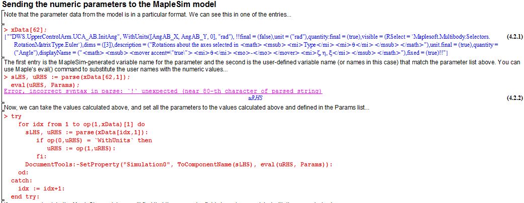

I found an already done model (from this link) that seems to be perfect to me because contains an attached Maple document that does exactly what I need working on the base of symbolic parameters applied to the MapleSim model. Now my problem is that I need to deeply change the model and so having the possibility to change the parameter set and insert for example nex parameters. But when I try to do that some problems come out with the Maple document: the syntax of the nex parameter set is different from the default (in the sense of already built in the model I downloaded) one and there are some syntax errors. Below I'll put a screenshot of the error.
under the XData code line, you can also see the syntax of one of the parameters that is very long and complicated: below I'll insert another image from which it can be seen the syntax with the original parameter set.
