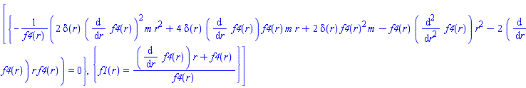

Question: How do I get dsolve to find the solution without substitution of the first equation
with(ODETools):
eqn1 := ((diff(f4(r), r))*r-f4(r)*f1(r)+f4(r))/(f4(r)*r^2) = 0
eqn4 := f4(r)*(r*(diff(f1(r), r))+f1(r)^2-f1(r))/(f1(r)^2*r^2) = 2*m*Dirac(r)*f4(r)/r^2
dsolve({eqn1, eqn4})
[{-(2*Dirac(r)*(diff(f4(r), r))^2*m*r^2+4*Dirac(r)*(diff(f4(r), r))*f4(r)*m*r+2*Dirac(r)*f4(r)^2*m-f4(r)*(diff(diff(f4(r), r), r))*r^2-2*(diff(f4(r), r))*r*f4(r))/f4(r) = 0}, {f1(r) = ((diff(f4(r), r))*r+f4(r))/f4(r)}]
When I try to solve this system of ODE, Maple does not factor out f4(r) in eqn4.  How do I get Maple to solve eqn4? So that I can get the correct result for f1(r) below:
dsolve((r*(diff(f1(r), r))+f1(r)^2-f1(r))/(f1(r)^2*r^2) = 2*m*Dirac(r)/r^2)
f1(r) = -r/(2*m*Heaviside(r)-_C1-r)
