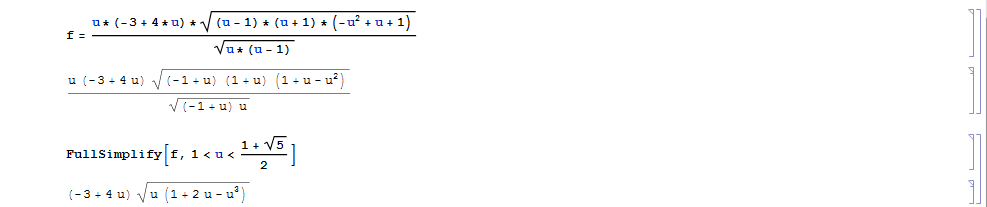

 Remark by Markiyan Hirnyk. The below content is added by the questionner on 08.02.2016 .
What Mathematica Does
