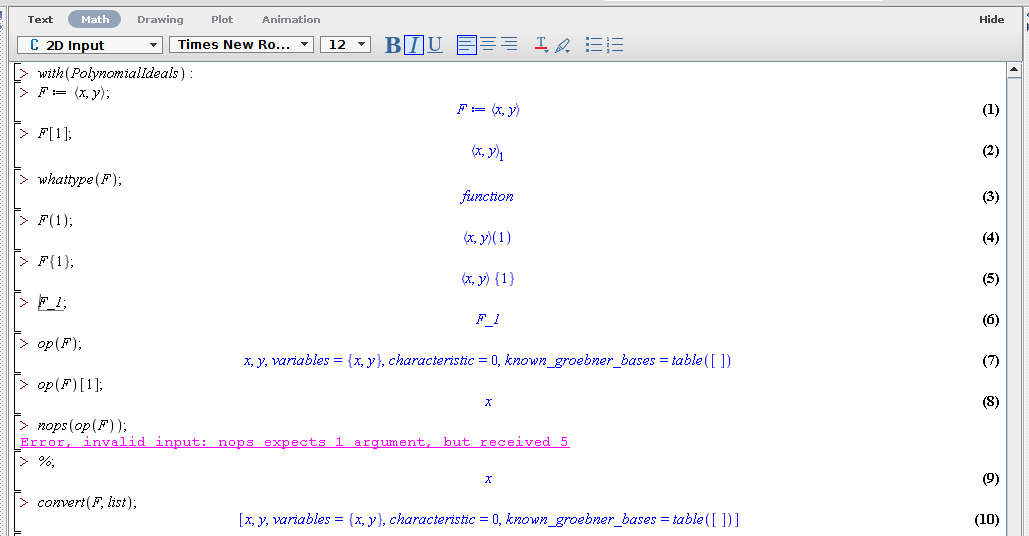

When one uses the PolynomialIdeals package, then how should he ask the elemnts in an ideal or the number of generators?
An idea can be writing a proc getting a polynomialideal and returning a list with the generators as its elements in this way. Converting the polynomialideal to a list, then deleting its three last entries. But I'm wondering if there is any other way to do this? It's reasonable to be able to ask generators of an ideal of result of some computations in polynomialideal package.
