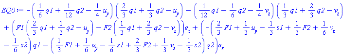

EQ0 := VectorCalculus:-`+`(VectorCalculus:-`+`(Typesetting:-delayDotProduct(`<|>`(F1, F2), VectorCalculus:-`+`(Typesetting:-delayDotProduct(1/M, `<,>`(q1, q2)), VectorCalculus:-`-`(`<,>`(U[y], V[z])))), VectorCalculus:-`-`(Typesetting:-delayDotProduct(VectorCalculus:-`*`(1/4, VectorCalculus:-`+`(Typesetting:-delayDotProduct(1/M, `<,>`(q1, q2)), VectorCalculus:-`-`(`<,>`(U[y], V[z])))^%T), VectorCalculus:-`+`(Typesetting:-delayDotProduct(1/M, `<,>`(q1, q2)), VectorCalculus:-`-`(`<,>`(U[y], V[z])))))), VectorCalculus:-`-`(Typesetting:-delayDotProduct(Typesetting:-delayDotProduct(VectorCalculus:-`*`(1/2, `<|>`(VectorCalculus:-`+`(VectorCalculus:-`+`(VectorCalculus:-`*`(2, F1), U[y]), VectorCalculus:-`-`(s1)), VectorCalculus:-`+`(VectorCalculus:-`+`(VectorCalculus:-`*`(2, F2), V[z]), VectorCalculus:-`-`(s2)))), 1/M), `<,>`(q1, q2))))
EQ0 := -((1/6)*q1+(1/12)*q2-(1/4)*(diff(u(y, z), y)))*((2/3)*q1+(1/3)*q2-(diff(u(y, z), y)))-((1/12)*q1+(1/6)*q2-(1/4)*(diff(v(y, z), z)))*((1/3)*q1+(2/3)*q2-(diff(v(y, z), z)))+(Vector(1, {(1) = F1*((2/3)*q1+(1/3)*q2-(diff(u(y, z), y)))+F2*((1/3)*q1+(2/3)*q2-(diff(v(y, z), z)))}, attributes = [coords = cartesian]))+(Vector(1, {(1) = -((2/3)*F1+(1/3)*(diff(u(y, z), y))-(1/3)*s1+(1/3)*F2+(1/6)*(diff(v(y, z), z))-(1/6)*s2)*q1-((1/3)*F1+(1/6)*(diff(u(y, z), y))-(1/6)*s1+(2/3)*F2+(1/3)*(diff(v(y, z), z))-(1/3)*s2)*q2}, attributes = [coords = cartesian]))

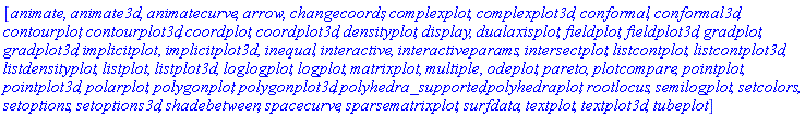

with(PDEtools); -1; with(plots)
[animate, animate3d, animatecurve, arrow, changecoords, complexplot, complexplot3d, conformal, conformal3d, contourplot, contourplot3d, coordplot, coordplot3d, densityplot, display, dualaxisplot, fieldplot, fieldplot3d, gradplot, gradplot3d, implicitplot, implicitplot3d, inequal, interactive, interactiveparams, intersectplot, listcontplot, listcontplot3d, listdensityplot, listplot, listplot3d, loglogplot, logplot, matrixplot, multiple, odeplot, pareto, plotcompare, pointplot, pointplot3d, polarplot, polygonplot, polygonplot3d, polyhedra_supported, polyhedraplot, rootlocus, semilogplot, setcolors, setoptions, setoptions3d, shadebetween, spacecurve, sparsematrixplot, surfdata, textplot, textplot3d, tubeplot]

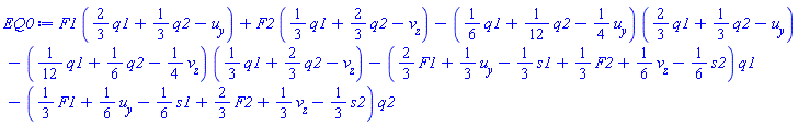

EQ0 := Typesetting:-delayDotProduct(`<|>`(F1, F2), Typesetting:-delayDotProduct(1/M, `<,>`(q1, q2))+`-`(`<,>`(U[y], V[z])))+`-`(Typesetting:-delayDotProduct(VectorCalculus:-`*`(1/4, (Typesetting:-delayDotProduct(1/M, `<,>`(q1, q2))+`-`(`<,>`(U[y], V[z])))^%T), Typesetting:-delayDotProduct(1/M, `<,>`(q1, q2))+`-`(`<,>`(U[y], V[z]))))+`-`(Typesetting:-delayDotProduct(Typesetting:-delayDotProduct(VectorCalculus:-`*`(1/2, `<|>`(VectorCalculus:-`*`(2, F1)+U[y]+`-`(s1), VectorCalculus:-`*`(2, F2)+V[z]+`-`(s2))), 1/M), `<,>`(q1, q2)))
F1*((2/3)*q1+(1/3)*q2-(diff(u(y, z), y)))+F2*((1/3)*q1+(2/3)*q2-(diff(v(y, z), z)))-((1/6)*q1+(1/12)*q2-(1/4)*(diff(u(y, z), y)))*((2/3)*q1+(1/3)*q2-(diff(u(y, z), y)))-((1/12)*q1+(1/6)*q2-(1/4)*(diff(v(y, z), z)))*((1/3)*q1+(2/3)*q2-(diff(v(y, z), z)))-((2/3)*F1+(1/3)*(diff(u(y, z), y))-(1/3)*s1+(1/3)*F2+(1/6)*(diff(v(y, z), z))-(1/6)*s2)*q1-((1/3)*F1+(1/6)*(diff(u(y, z), y))-(1/6)*s1+(2/3)*F2+(1/3)*(diff(v(y, z), z))-(1/3)*s2)*q2

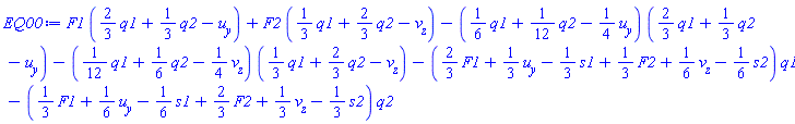

EQ00 := VectorCalculus:-`+`(VectorCalculus:-`+`(Typesetting:-delayDotProduct(`<|>`(F1, F2), VectorCalculus:-`+`(Typesetting:-delayDotProduct(1/M, `<,>`(q1, q2)), VectorCalculus:-`-`(`<,>`(U[y], V[z])))), VectorCalculus:-`-`(Typesetting:-delayDotProduct(VectorCalculus:-`*`(1/4, VectorCalculus:-`+`(Typesetting:-delayDotProduct(1/M, `<,>`(q1, q2)), VectorCalculus:-`-`(`<,>`(U[y], V[z])))^%T), VectorCalculus:-`+`(Typesetting:-delayDotProduct(1/M, `<,>`(q1, q2)), VectorCalculus:-`-`(`<,>`(U[y], V[z])))))), VectorCalculus:-`-`(Typesetting:-delayDotProduct(Typesetting:-delayDotProduct(VectorCalculus:-`*`(1/2, VectorCalculus:-`+`(VectorCalculus:-`+`(VectorCalculus:-`*`(2, `<|>`(F1, F2)), `<|>`(U[y], V[z])), VectorCalculus:-`-`(`<|>`(s1, s2)))), 1/M), `<,>`(q1, q2))))
