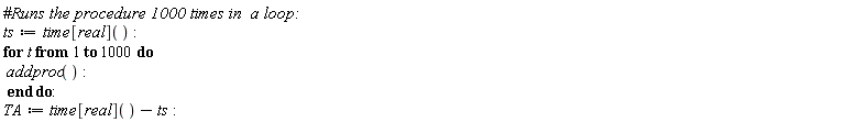

ts := time[real](); for t to 1000 do addproc() end do; TA := time[real]()-ts

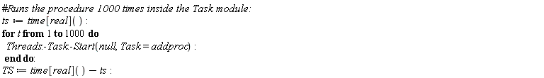

ts := time[real](); for t to 1000 do Threads:-Task:-Start(null, Task = addproc) end do; TS := time[real]()-ts

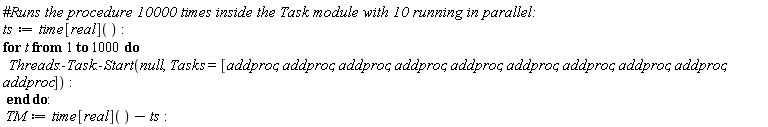

ts := time[real](); for t to 1000 do Threads:-Task:-Start(null, Tasks = [addproc, addproc, addproc, addproc, addproc, addproc, addproc, addproc, addproc, addproc]) end do; TM := time[real]()-ts

0.33e-1
2.049
2.006
