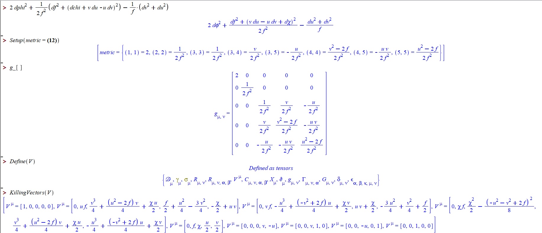

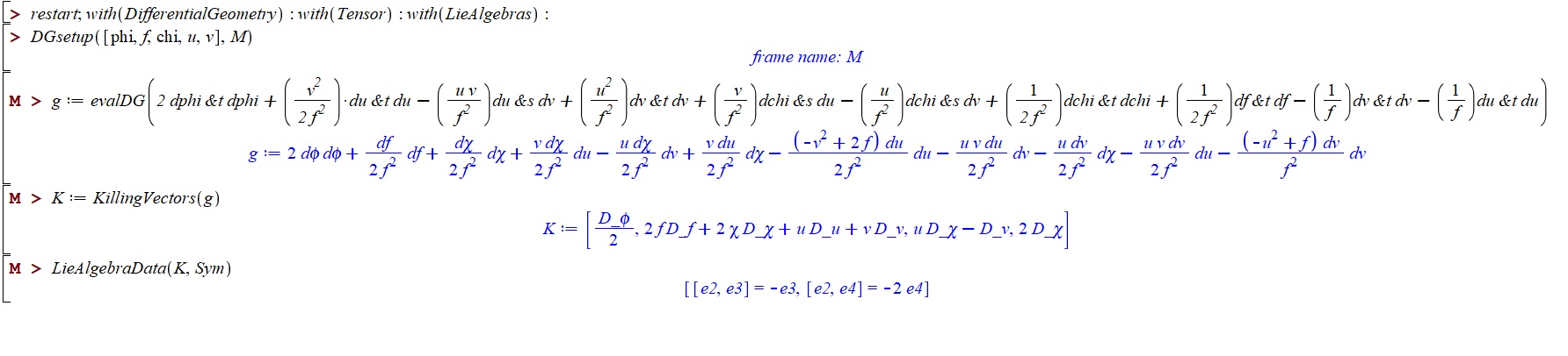

I am trying to calculate the Killing vectors for the metric below. For such, I used the packages DifferentialGeometry and Physics. However, I found different results these packages. Could someone explain why?
Thanks in advance!
killing_test1.mw
killing_test2.mw
