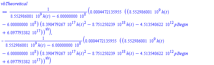

vbTheoretical := solve(eq2, vb)
0.4472135955e-3*((8552986001.*h(t)-600000000.)*(0.8390479267e18*h(t)^2-0.8751250239e19*h(t)-0.4513540622e13*pBegin+0.6097793382e18))^(1/2)/(8552986001.*h(t)-600000000.), -0.4472135955e-3*((8552986001.*h(t)-600000000.)*(0.8390479267e18*h(t)^2-0.8751250239e19*h(t)-0.4513540622e13*pBegin+0.6097793382e18))^(1/2)/(8552986001.*h(t)-600000000.)
(3.2)

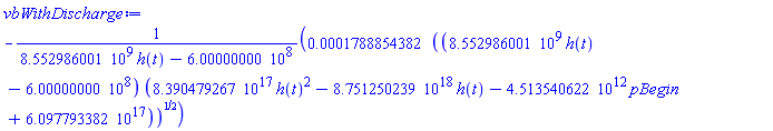

vbWithDischarge := Cd.vbTheoretical[2]
-0.1788854382e-3*((8552986001.*h(t)-600000000.)*(0.8390479267e18*h(t)^2-0.8751250239e19*h(t)-0.4513540622e13*pBegin+0.6097793382e18))^(1/2)/(8552986001.*h(t)-600000000.)
(3.3)

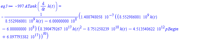

eq3 := -`ρWater`*ATank*(diff(h(t), t)) = `ρWater`*ANozzle*vbWithDischarge
-997*ATank*(diff(h(t), t)) = -0.1400748058e-6*((8552986001.*h(t)-600000000.)*(0.8390479267e18*h(t)^2-0.8751250239e19*h(t)-0.4513540622e13*pBegin+0.6097793382e18))^(1/2)/(8552986001.*h(t)-600000000.)
(4.1)

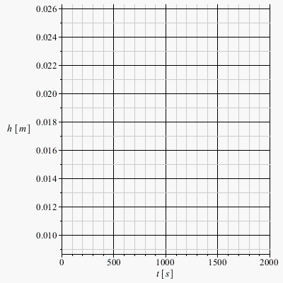

plot(h(t), t = 0 .. 2000, labels = ['t'*[s], 'h'*[m]])
Hi i am trying to get a graph that shows height against time but it does not plot and I do not understand why. I copied the code of a friend and it does work on his computer.
