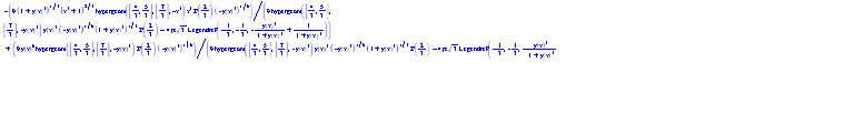

odetest(sol,ode);
-9*(1+y(x)^3)^(1/3)*(x^3+1)^(2/3)*hypergeom([4/3, 5/3], [7/3], -x^3)*x^3*GAMMA(2/3)*(-y(x)^3)^(1/6)/(9*hypergeom([4/3, 5/3], [7/3], -y(x)^3)*y(x)^3*(-y(x)^3)^(1/6)*(1+y(x)^3)^(1/3)*GAMMA(2/3)-4*Pi*3^(1/2)*LegendreP(-1/3, -1/3, -y(x)^3/(1+y(x)^3)+1/(1+y(x)^3)))+9*y(x)^6*hypergeom([4/3, 5/3], [7/3], -y(x)^3)*GAMMA(2/3)*(-y(x)^3)^(1/6)/(9*hypergeom([4/3, 5/3], [7/3], -y(x)^3)*y(x)^3*(-y(x)^3)^(1/6)*(1+y(x)^3)^(1/3)*GAMMA(2/3)-4*Pi*3^(1/2)*LegendreP(-1/3, -1/3, -y(x)^3/(1+y(x)^3)+1/(1+y(x)^3)))+9*y(x)^3*hypergeom([4/3, 5/3], [7/3], -y(x)^3)*GAMMA(2/3)*(-y(x)^3)^(1/6)/(9*hypergeom([4/3, 5/3], [7/3], -y(x)^3)*y(x)^3*(-y(x)^3)^(1/6)*(1+y(x)^3)^(1/3)*GAMMA(2/3)-4*Pi*3^(1/2)*LegendreP(-1/3, -1/3, -y(x)^3/(1+y(x)^3)+1/(1+y(x)^3)))-4*(1+y(x)^3)^(2/3)*Pi*3^(1/2)*LegendreP(-1/3, -1/3, -(y(x)^3-1)/(1+y(x)^3))/(9*hypergeom([4/3, 5/3], [7/3], -y(x)^3)*y(x)^3*(-y(x)^3)^(1/6)*(1+y(x)^3)^(1/3)*GAMMA(2/3)-4*Pi*3^(1/2)*LegendreP(-1/3, -1/3, -y(x)^3/(1+y(x)^3)+1/(1+y(x)^3)))+4*(1+y(x)^3)^(1/3)*(x^3+1)^(1/3)*Pi*3^(1/2)*LegendreP(-1/3, -1/3, -(x^3-1)/(x^3+1))*(-y(x)^3)^(1/6)/((-x^3)^(1/6)*(9*hypergeom([4/3, 5/3], [7/3], -y(x)^3)*y(x)^3*(-y(x)^3)^(1/6)*(1+y(x)^3)^(1/3)*GAMMA(2/3)-4*Pi*3^(1/2)*LegendreP(-1/3, -1/3, -y(x)^3/(1+y(x)^3)+1/(1+y(x)^3))))

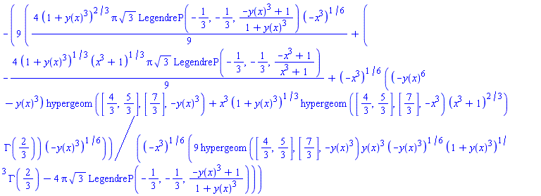

simplify(%);
-9*((4/9)*(1+y(x)^3)^(2/3)*Pi*3^(1/2)*LegendreP(-1/3, -1/3, (-y(x)^3+1)/(1+y(x)^3))*(-x^3)^(1/6)+(-(4/9)*(1+y(x)^3)^(1/3)*(x^3+1)^(1/3)*Pi*3^(1/2)*LegendreP(-1/3, -1/3, (-x^3+1)/(x^3+1))+(-x^3)^(1/6)*((-y(x)^6-y(x)^3)*hypergeom([4/3, 5/3], [7/3], -y(x)^3)+x^3*(1+y(x)^3)^(1/3)*hypergeom([4/3, 5/3], [7/3], -x^3)*(x^3+1)^(2/3))*GAMMA(2/3))*(-y(x)^3)^(1/6))/((-x^3)^(1/6)*(9*hypergeom([4/3, 5/3], [7/3], -y(x)^3)*y(x)^3*(-y(x)^3)^(1/6)*(1+y(x)^3)^(1/3)*GAMMA(2/3)-4*Pi*3^(1/2)*LegendreP(-1/3, -1/3, (-y(x)^3+1)/(1+y(x)^3))))
