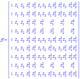

ff := convert([ seq(es(entries(ffd[i,..], nolist)), i=1..N^P) ], Matrix);
UnityRoots := [solve(z^3=1, z)]:
F := simplify(subs(niv =~ UnityRoots, ff)) /~ sqrt(N^P):
ff := Matrix(9, 9, {(1, 1) = 1, (1, 2) = Z[1], (1, 3) = Z[2], (1, 4) = Z[1]^2, (1, 5) = Z[2]^2, (1, 6) = Z[1]*Z[2], (1, 7) = Z[1]*Z[2]^2, (1, 8) = Z[1]^2*Z[2], (1, 9) = Z[1]^2*Z[2]^2, (2, 1) = 1, (2, 2) = Z[1], (2, 3) = Z[3], (2, 4) = Z[1]^2, (2, 5) = Z[3]^2, (2, 6) = Z[1]*Z[3], (2, 7) = Z[1]*Z[3]^2, (2, 8) = Z[1]^2*Z[3], (2, 9) = Z[1]^2*Z[3]^2, (3, 1) = 1, (3, 2) = Z[1], (3, 3) = Z[1], (3, 4) = Z[1]^2, (3, 5) = Z[1]^2, (3, 6) = Z[1]^2, (3, 7) = Z[1]^3, (3, 8) = Z[1]^3, (3, 9) = Z[1]^4, (4, 1) = 1, (4, 2) = Z[2], (4, 3) = Z[2], (4, 4) = Z[2]^2, (4, 5) = Z[2]^2, (4, 6) = Z[2]^2, (4, 7) = Z[2]^3, (4, 8) = Z[2]^3, (4, 9) = Z[2]^4, (5, 1) = 1, (5, 2) = Z[2], (5, 3) = Z[3], (5, 4) = Z[2]^2, (5, 5) = Z[3]^2, (5, 6) = Z[2]*Z[3], (5, 7) = Z[2]*Z[3]^2, (5, 8) = Z[2]^2*Z[3], (5, 9) = Z[2]^2*Z[3]^2, (6, 1) = 1, (6, 2) = Z[2], (6, 3) = Z[1], (6, 4) = Z[2]^2, (6, 5) = Z[1]^2, (6, 6) = Z[1]*Z[2], (6, 7) = Z[1]^2*Z[2], (6, 8) = Z[1]*Z[2]^2, (6, 9) = Z[1]^2*Z[2]^2, (7, 1) = 1, (7, 2) = Z[3], (7, 3) = Z[2], (7, 4) = Z[3]^2, (7, 5) = Z[2]^2, (7, 6) = Z[2]*Z[3], (7, 7) = Z[2]^2*Z[3], (7, 8) = Z[2]*Z[3]^2, (7, 9) = Z[2]^2*Z[3]^2, (8, 1) = 1, (8, 2) = Z[3], (8, 3) = Z[3], (8, 4) = Z[3]^2, (8, 5) = Z[3]^2, (8, 6) = Z[3]^2, (8, 7) = Z[3]^3, (8, 8) = Z[3]^3, (8, 9) = Z[3]^4, (9, 1) = 1, (9, 2) = Z[3], (9, 3) = Z[1], (9, 4) = Z[3]^2, (9, 5) = Z[1]^2, (9, 6) = Z[1]*Z[3], (9, 7) = Z[1]^2*Z[3], (9, 8) = Z[1]*Z[3]^2, (9, 9) = Z[1]^2*Z[3]^2})
