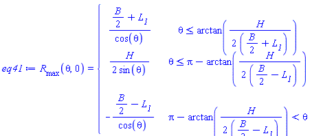

eq41:=R__max(theta,0)=piecewise(theta<=rhs(eq02),(B/2+L__1)/cos(theta),theta<=rhs(eq03),(H/2)/sin(theta),rhs(eq03)<theta,(B/2-L__1)/cos(Pi-theta));

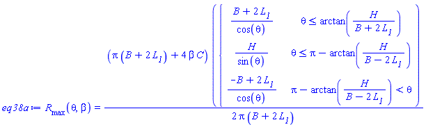

eq38a:= simplify(subs([eq41,eq39a,eq0], eq38));

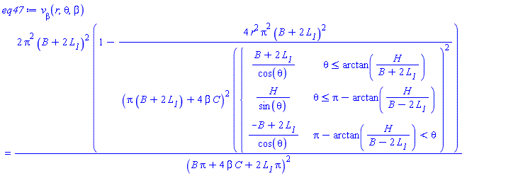

eq47:=subs([eq44b,eq38a],eq43);

eq41 := R__max(theta, 0) = piecewise(theta <= arctan(H/(2*((1/2)*B+L__1))), ((1/2)*B+L__1)/cos(theta), theta <= Pi-arctan(H/(2*((1/2)*B-L__1))), H/(2*sin(theta)), Pi-arctan(H/(2*((1/2)*B-L__1))) < theta, -((1/2)*B-L__1)/cos(theta))
eq38a := R__max(theta, beta) = (Pi*(B+2*L__1)+4*beta*C)*piecewise(theta <= arctan(H/(B+2*L__1)), (B+2*L__1)/cos(theta), theta <= Pi-arctan(H/(B-2*L__1)), H/sin(theta), Pi-arctan(H/(B-2*L__1)) < theta, (-B+2*L__1)/cos(theta))/(2*Pi*(B+2*L__1))

v__beta(r, theta, beta) = 2*Pi^2*(B+2*L__1)^2*(1-4*r^2*Pi^2*(B+2*L__1)^2/((Pi*(B+2*L__1)+4*beta*C)^2*piecewise(theta <= arctan(H/(B+2*L__1)), (B+2*L__1)/cos(theta), theta <= Pi-arctan(H/(B-2*L__1)), H/sin(theta), Pi-arctan(H/(B-2*L__1)) < theta, (-B+2*L__1)/cos(theta))^2))/(B*Pi+4*C*beta+2*L__1*Pi)^2

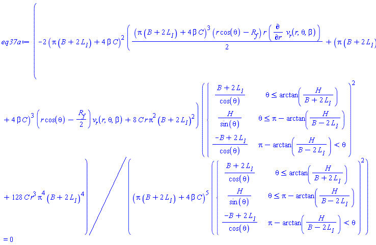

eq37a:=simplify(expand(subs(eq47, eq37)));

(-2*(Pi*(B+2*L__1)+4*beta*C)^2*((1/2)*(Pi*(B+2*L__1)+4*beta*C)^3*(r*cos(theta)-R__f)*r*(diff(v__r(r, theta, beta), r))+(Pi*(B+2*L__1)+4*beta*C)^3*(r*cos(theta)-(1/2)*R__f)*v__r(r, theta, beta)+8*C*r*Pi^2*(B+2*L__1)^2)*piecewise(theta <= arctan(H/(B+2*L__1)), (B+2*L__1)/cos(theta), theta <= Pi-arctan(H/(B-2*L__1)), H/sin(theta), Pi-arctan(H/(B-2*L__1)) < theta, (-B+2*L__1)/cos(theta))^2+128*C*r^3*Pi^4*(B+2*L__1)^4)/((Pi*(B+2*L__1)+4*beta*C)^5*piecewise(theta <= arctan(H/(B+2*L__1)), (B+2*L__1)/cos(theta), theta <= Pi-arctan(H/(B-2*L__1)), H/sin(theta), Pi-arctan(H/(B-2*L__1)) < theta, (-B+2*L__1)/cos(theta))^2) = 0

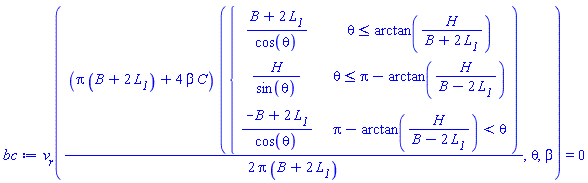

bc:=v__r(rhs(eq38a),theta,beta)=0;
bc := v__r((Pi*(B+2*L__1)+4*beta*C)*piecewise(theta <= arctan(H/(B+2*L__1)), (B+2*L__1)/cos(theta), theta <= Pi-arctan(H/(B-2*L__1)), H/sin(theta), Pi-arctan(H/(B-2*L__1)) < theta, (-B+2*L__1)/cos(theta))/(2*Pi*(B+2*L__1)), theta, beta) = 0
