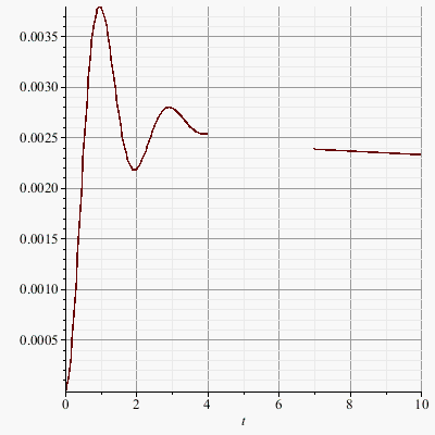

The plot of the solution contains a "hole" which, in fact, corresponds to the range where the formal solution is not real.
This seemed strange to me as I expected a real solution.

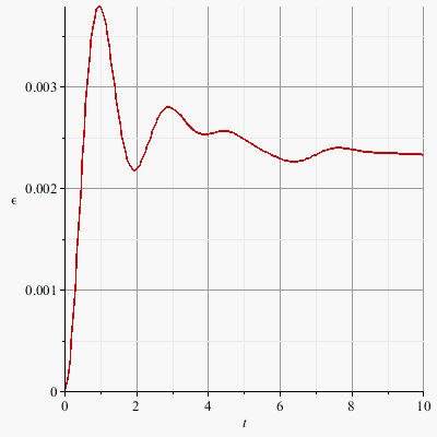

So I solved this ODE numerically and this gave me a real solution.

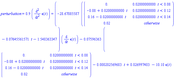

perturbation := .9*(diff(epsilon(t), t, t)) = (-28.67085587*piecewise(0.2000000000e-1*t < 0.8e-1, 0., 0.2000000000e-1*t < .12, -0.8e-1+0.2000000000e-1*t, 0.2000000000e-1*t < .14, .16-0.2000000000e-1*t, 0.2e-1)-0.7645561571e-1*t-1.548363347)*(diff(epsilon(t), t))-0.7596363e-1*piecewise(0.2000000000e-1*t < 0.8e-1, 0., 0.2000000000e-1*t < .12, -0.8e-1+0.2000000000e-1*t, 0.2000000000e-1*t < .14, .16-0.2000000000e-1*t, 0.2e-1)-0.202569683e-3*t+0.26997403e-1-10.10*epsilon(t)
perturbation := .9*(diff(`&epsilon;`(t), t, t)) = (-28.67085587*piecewise(0.2000000000e-1*t < 0.8e-1, 0., 0.2000000000e-1*t < .12, -0.8e-1+0.2000000000e-1*t, 0.2000000000e-1*t < .14, .16-0.2000000000e-1*t, 0.2e-1)-0.7645561571e-1*t-1.548363347)*(diff(`&epsilon;`(t), t))-0.7596363e-1*piecewise(0.2000000000e-1*t < 0.8e-1, 0., 0.2000000000e-1*t < .12, -0.8e-1+0.2000000000e-1*t, 0.2000000000e-1*t < .14, .16-0.2000000000e-1*t, 0.2e-1)-0.202569683e-3*t+0.26997403e-1-10.10*`&epsilon;`(t)

EPS := rhs( dsolve({evalf(perturbation), epsilon(0)=0, D(epsilon)(0)=0}, epsilon(t)) ):
# a lengthy expression that involves Kummer's special functions
plot(EPS, t=0..10, gridlines=true);
Digits:=20:
evalf(eval(EPS, t=5));
Digits:=10:
-0.26529838913395427314e88+0.10340147081332027605e89*I
numsol := dsolve({perturbation, epsilon(0)=0, D(epsilon)(0)=0}, numeric):
odeplot(numsol, [t, epsilon(t)], t=0..10, gridlines=true, color=red)
