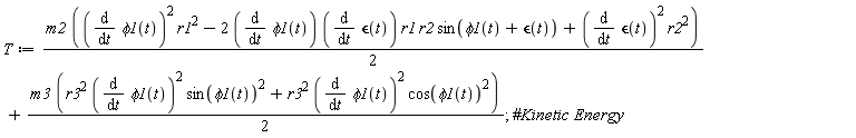

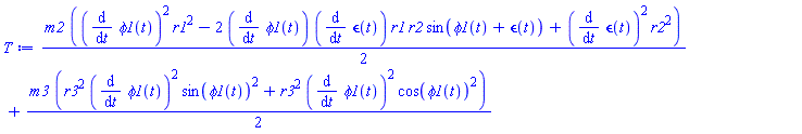

T := (1/2)*m2*((diff(phi1(t), t))^2*r1^2-2*(diff(phi1(t), t))*(diff(`ε`(t), t))*r1*r2*sin(phi1(t)+`ε`(t))+(diff(`ε`(t), t))^2*r2^2)+(1/2)*m3*(r3^2*(diff(phi1(t), t))^2*sin(phi1(t))^2+r3^2*(diff(phi1(t), t))^2*cos(phi1(t))^2)
(1/2)*m2*((diff(phi1(t), t))^2*r1^2-2*(diff(phi1(t), t))*(diff(epsilon(t), t))*r1*r2*sin(phi1(t)+epsilon(t))+(diff(epsilon(t), t))^2*r2^2)+(1/2)*m3*(r3^2*(diff(phi1(t), t))^2*sin(phi1(t))^2+r3^2*(diff(phi1(t), t))^2*cos(phi1(t))^2)

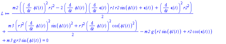

L := T-U = 0
(1/2)*m2*((diff(phi1(t), t))^2*r1^2-2*(diff(phi1(t), t))*(diff(epsilon(t), t))*r1*r2*sin(phi1(t)+epsilon(t))+(diff(epsilon(t), t))^2*r2^2)+(1/2)*m3*(r3^2*(diff(phi1(t), t))^2*sin(phi1(t))^2+r3^2*(diff(phi1(t), t))^2*cos(phi1(t))^2)-m2*g*(r1*sin(phi1(t))+r2*cos(epsilon(t)))+m3*g*r3*sin(phi1(t)) = 0

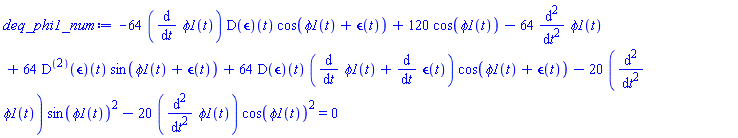

deq_phi1_num := EulerLagrange(L_num, t, phi1(t)); hz1 := convert(deq_phi1_num, list); deq_phi1_num := op(1, hz1)
-64*(diff(phi1(t), t))*(D(epsilon))(t)*cos(phi1(t)+epsilon(t))+120*cos(phi1(t))-64*(diff(diff(phi1(t), t), t))+64*((D@@2)(epsilon))(t)*sin(phi1(t)+epsilon(t))+64*(D(epsilon))(t)*(diff(phi1(t), t)+diff(epsilon(t), t))*cos(phi1(t)+epsilon(t))-20*(diff(diff(phi1(t), t), t))*sin(phi1(t))^2-20*(diff(diff(phi1(t), t), t))*cos(phi1(t))^2 = 0

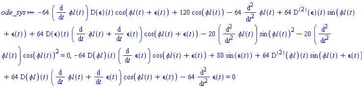

ode_sys := deq_phi1_num, deq_epsilon_num
-64*(diff(phi1(t), t))*(D(epsilon))(t)*cos(phi1(t)+epsilon(t))+120*cos(phi1(t))-64*(diff(diff(phi1(t), t), t))+64*((D@@2)(epsilon))(t)*sin(phi1(t)+epsilon(t))+64*(D(epsilon))(t)*(diff(phi1(t), t)+diff(epsilon(t), t))*cos(phi1(t)+epsilon(t))-20*(diff(diff(phi1(t), t), t))*sin(phi1(t))^2-20*(diff(diff(phi1(t), t), t))*cos(phi1(t))^2 = 0, -64*(D(phi1))(t)*(diff(epsilon(t), t))*cos(phi1(t)+epsilon(t))+80*sin(epsilon(t))+64*((D@@2)(phi1))(t)*sin(phi1(t)+epsilon(t))+64*(D(phi1))(t)*(diff(phi1(t), t)+diff(epsilon(t), t))*cos(phi1(t)+epsilon(t))-64*(diff(diff(epsilon(t), t), t)) = 0
