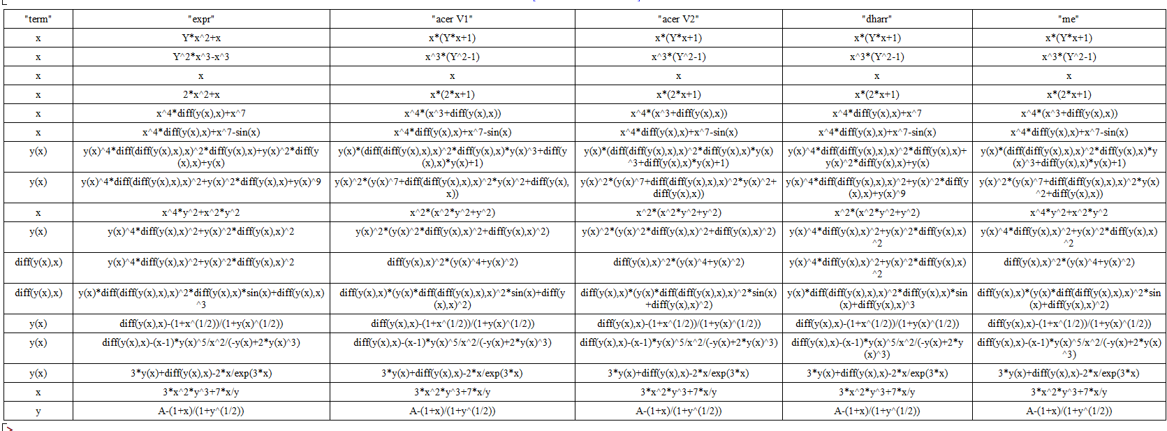

update
I've updated the test cases and included all algorithms given to compare. It is hard in Maple to make a nice table to present results and keep math formatting below.

RESULT
how_to_do_special_factor.mw
Mapleprime will not let let insert content for some reason. Here is the output as screen shot but it is hard to read. But it is in the above worksheet.
