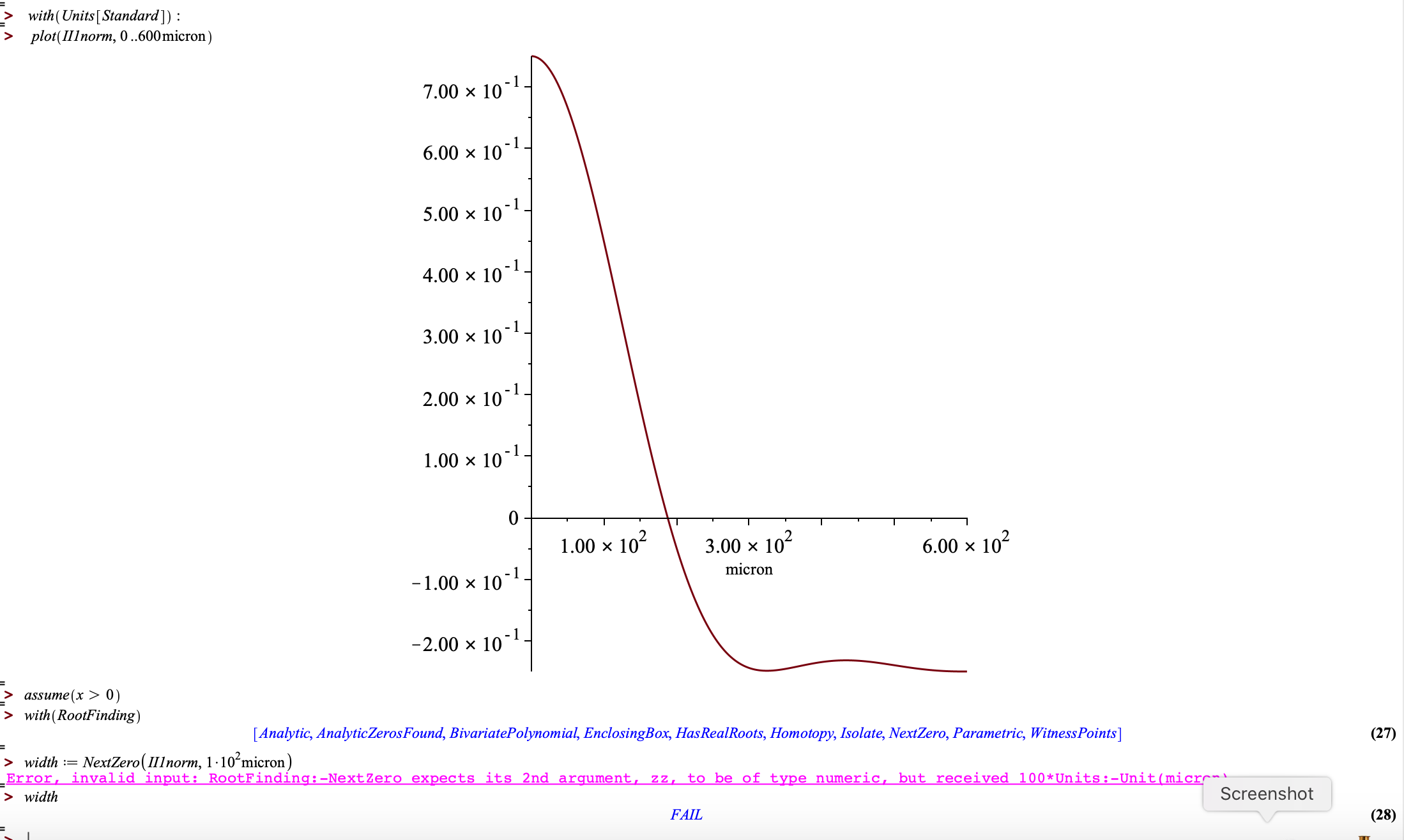

Question: What do I get an error message using NextRoot with units?
I have defined a function II1norm of one variable. The variable has units "microns". It plots perfecting using a range defined in microns, but gives an error when I try to find the root using NextZero. If I just leave off the "microns" in the second argument, NextRoot just reports "FAIL". If I rewite the worksheet without units, then the NextZero executes fine. Why? How to I use units when finding roots?
