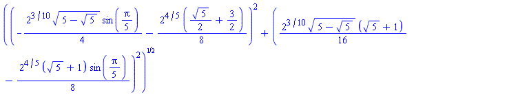

sqrt( Re(v)^2 + Im(v)^2 );
((-(1/4)*2^(3/10)*(5-5^(1/2))^(1/2)*sin((1/5)*Pi)-(1/8)*2^(4/5)*((1/2)*5^(1/2)+3/2))^2+((1/16)*2^(3/10)*(5-5^(1/2))^(1/2)*(5^(1/2)+1)-(1/8)*2^(4/5)*(5^(1/2)+1)*sin((1/5)*Pi))^2)^(1/2)

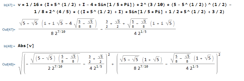

Here is the same thing in Mathematica:
