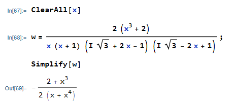

It would be nice if Maple simplify would just do it directly as follows in Mathematica. May be there is a an  option I am overlooking
