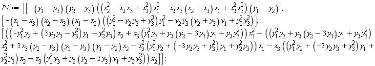

P1 := Vector(3, {(1) = -(y[1]-y[3])*(y[2]-y[3])*((x[2]^2-x[2]*x[3]+x[3]^2)*x[1]^2-x[2]*x[3]*(x[2]+x[3])*x[1]+x[2]^2*x[3]^2)*(y[1]-y[2]), (2) = -(x[1]-x[3])*(x[2]-x[3])*(x[1]-x[2])*((y[2]^2-y[2]*y[3]+y[3]^2)*y[1]^2-y[2]*y[3]*(y[2]+y[3])*y[1]+y[2]^2*y[3]^2), (3) = ((-y[1]^2*y[2]+(3*y[2]*y[3]-y[3]^2)*y[1]-y[2]^2*y[3])*x[2]+x[3]*(y[1]^2*y[3]+y[2]*(y[2]-3*y[3])*y[1]+y[2]*y[3]^2))*x[1]^2+((y[1]^2*y[3]+y[2]*(y[2]-3*y[3])*y[1]+y[2]*y[3]^2)*x[2]^2+3*x[3]*(y[2]-y[3])*(y[1]-y[3])*(y[1]-y[2])*x[2]-x[3]^2*(y[1]^2*y[2]+(-3*y[2]*y[3]+y[3]^2)*y[1]+y[2]^2*y[3]))*x[1]-x[3]*((y[1]^2*y[2]+(-3*y[2]*y[3]+y[3]^2)*y[1]+y[2]^2*y[3])*x[2]-x[3]*(y[1]^2*y[3]+y[2]*(y[2]-3*y[3])*y[1]+y[2]*y[3]^2))*x[2]})

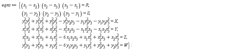

eqns := {(x[1]-x[2])*(x[2]-x[3])*(x[3]-x[1]) = R, (y[1]-y[2])*(y[2]-y[3])*(y[3]-y[1]) = S, x[1]^2*x[2]^2-x[1]^2*x[2]*x[3]+x[1]^2*x[3]^2-x[1]*x[2]^2*x[3]-x[1]*x[2]*x[3]^2+x[2]^2*x[3]^2 = Y, y[1]^2*y[2]^2-y[1]^2*y[2]*y[3]+y[1]^2*y[3]^2-y[1]*y[2]^2*y[3]-y[1]*y[2]*y[3]^2+y[2]^2*y[3]^2 = X, x[1]^2*x[2]+x[1]^2*x[3]+x[1]*x[2]^2-6*x[1]*x[2]*x[3]+x[1]*x[3]^2+x[2]^2*x[3]+x[2]*x[3]^2 = Z, y[1]^2*y[2]+y[1]^2*y[3]+y[1]*y[2]^2-6*y[1]*y[2]*y[3]+y[1]*y[3]^2+y[2]^2*y[3]+y[2]*y[3]^2 = W}
