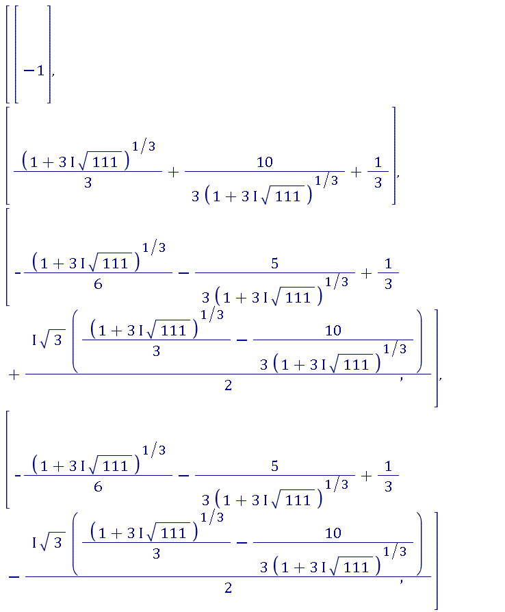

Eigenvalues(A2);
Vector(4, {(1) = -1, (2) = (1/3)*(1+(3*I)*sqrt(111))^(1/3)+(10/3)/(1+(3*I)*sqrt(111))^(1/3)+1/3, (3) = -(1/6)*(1+(3*I)*sqrt(111))^(1/3)-(5/3)/(1+(3*I)*sqrt(111))^(1/3)+1/3+((1/2)*I)*sqrt(3)*((1/3)*(1+(3*I)*sqrt(111))^(1/3)-(10/3)/(1+(3*I)*sqrt(111))^(1/3)), (4) = -(1/6)*(1+(3*I)*sqrt(111))^(1/3)-(5/3)/(1+(3*I)*sqrt(111))^(1/3)+1/3-((1/2)*I)*sqrt(3)*((1/3)*(1+(3*I)*sqrt(111))^(1/3)-(10/3)/(1+(3*I)*sqrt(111))^(1/3))})

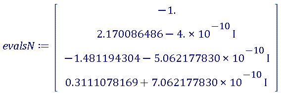

evalsN:=evalf(%);
Vector(4, {(1) = -1., (2) = 2.170086486-0.4000000000e-9*I, (3) = -1.481194304-0.5062177830e-9*I, (4) = .3111078169+0.7062177830e-9*I})
