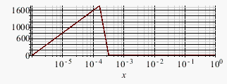

say the f(x) is a Beta with parameters alpha and beta
alpha := 10
10
beta := 100000
100000
"f(x):=PDF(BetaDistribution(alpha,beta),x)"
proc (x) options operator, arrow, function_assign; Statistics:-PDF(BetaDistribution(alpha, beta), x) end proc
f(x)
piecewise(x < 0, 0, x < 1, x^9*(1-x)^99999/Beta(10, 100000), 0)
semilogplot(PDF(BetaDistribution(alpha, beta), x), x = 0 .. 1)
fsolve(int(f(x), x = 0 .. y) = .1, y = 0 .. 1)
