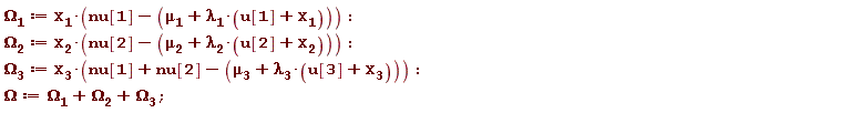

# 2.2.1 Define the Omega random variable as Omega__1+Omega__2+Omega__3:
`Ω__1` := X__1*(nu[1]-`μ__1`-`λ__1`*(u[1]+X__1)); `Ω__2` := X__2*(nu[2]-`μ__2`-`λ__2`*(u[2]+X__2)); `Ω__3` := X__3*(nu[1]+nu[2]-`μ__3`-`λ__3`*(u[3]+X__3)); Omega := `Ω__1`+`Ω__2`+`Ω__3`

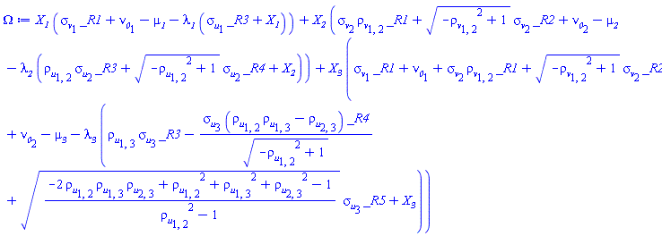

X__1*(sigma__v[1]*_R1+nu__0[1]-mu__1-lambda__1*(_R3*sigma__u[1]+X__1))+X__2*(sigma__v[2]*rho__v[1, 2]*_R1+(-rho__v[1, 2]^2+1)^(1/2)*sigma__v[2]*_R2+nu__0[2]-mu__2-lambda__2*(rho__u[1, 2]*sigma__u[2]*_R3+(-rho__u[1, 2]^2+1)^(1/2)*sigma__u[2]*_R4+X__2))+X__3*(sigma__v[1]*_R1+nu__0[1]+sigma__v[2]*rho__v[1, 2]*_R1+(-rho__v[1, 2]^2+1)^(1/2)*sigma__v[2]*_R2+nu__0[2]-mu__3-lambda__3*(rho__u[1, 3]*sigma__u[3]*_R3-sigma__u[3]*(rho__u[1, 2]*rho__u[1, 3]-rho__u[2, 3])*_R4/(-rho__u[1, 2]^2+1)^(1/2)+((-2*rho__u[1, 2]*rho__u[1, 3]*rho__u[2, 3]+rho__u[1, 2]^2+rho__u[1, 3]^2+rho__u[2, 3]^2-1)/(rho__u[1, 2]^2-1))^(1/2)*sigma__u[3]*_R5+X__3))

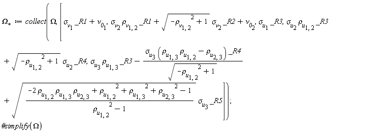

`Ω__*` := collect(Omega, [_R1*`σ__v`[1]+`ν__0`[1], `σ__v`[2]*`ρ__v`[1, 2]*_R1+sqrt(-`ρ__v`[1, 2]^2+1)*`σ__v`[2]*_R2+`ν__0`[2], `σ__u`[1]*_R3, `σ__u`[2]*`ρ__u`[1, 2]*_R3+sqrt(-`ρ__u`[1, 2]^2+1)*`σ__u`[2]*_R4, `σ__u`[3]*`ρ__u`[1, 3]*_R3-`σ__u`[3]*(`ρ__u`[1, 2]*`ρ__u`[1, 3]-`ρ__u`[2, 3])*_R4/sqrt(-`ρ__u`[1, 2]^2+1)+sqrt((-2*`ρ__u`[1, 2]*`ρ__u`[1, 3]*`ρ__u`[2, 3]+`ρ__u`[1, 2]^2+`ρ__u`[1, 3]^2+`ρ__u`[2, 3]^2-1)/(`ρ__u`[1, 2]^2-1))*`σ__u`[3]*_R5])
Error, (in collect) cannot collect _R1*sigma__v[1]+nu__0[1]
`Ω__col` := collect(Omega, [nu[1], nu[2], u[1], u[2], u[3]])
