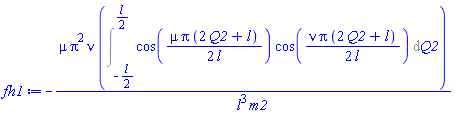

fh1:=simplify((-1/2/m2*Int(diff(phi(mu,Q2),Q2)*diff(phi(nu,Q2),Q2),Q2=-l/2..l/2)))
-mu*Pi^2*nu*(Int(cos((1/2)*mu*Pi*(2*Q2+l)/l)*cos((1/2)*nu*Pi*(2*Q2+l)/l), Q2 = -(1/2)*l .. (1/2)*l))/(l^3*m2)
convert(fh1,int) assuming(mu,integer,nu,integer);

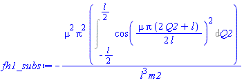

fh1_subs := simplify(subs(nu = mu, fh1));
-mu^2*Pi^2*(Int(cos((1/2)*mu*Pi*(2*Q2+l)/l)^2, Q2 = -(1/2)*l .. (1/2)*l))/(l^3*m2)
convert(fh1_substituted,int)assuming (mu,integer,nu,integer);
-(1/2)*mu^2*Pi^2/(l^2*m2)
