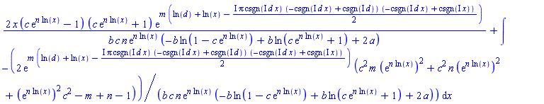

interface(version);
`Standard Worksheet Interface, Maple 2023.2, Windows 10, November 24 2023 Build ID 1762575`
integrand:=(d*x)^m/(a+b*arctanh(c*x^n))^2;
int(integrand,x);
2*x*(c*exp(n*ln(x))-1)*(c*exp(n*ln(x))+1)*exp(m*(ln(d)+ln(x)-((1/2)*I)*Pi*csgn(I*d*x)*(-csgn(I*d*x)+csgn(I*d))*(-csgn(I*d*x)+csgn(I*x))))/(b*c*n*exp(n*ln(x))*(-b*ln(1-c*exp(n*ln(x)))+b*ln(c*exp(n*ln(x))+1)+2*a))+int(-2*exp(m*(ln(d)+ln(x)-((1/2)*I)*Pi*csgn(I*d*x)*(-csgn(I*d*x)+csgn(I*d))*(-csgn(I*d*x)+csgn(I*x))))*(c^2*m*(exp(n*ln(x)))^2+c^2*n*(exp(n*ln(x)))^2+(exp(n*ln(x)))^2*c^2-m+n-1)/(b*c*n*exp(n*ln(x))*(-b*ln(1-c*exp(n*ln(x)))+b*ln(c*exp(n*ln(x))+1)+2*a)), x)
Download int_gparse_gmon_NO_error_maple_2023.mw
