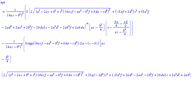

vars[1]:=x:vars[2]:=y:
eqn:= 8*(2*((a^2-2*a*c+b^2+c^2)*(4*a*c*f-a*e^2-b^2*f+b*d*e-c*d^2)^2)^(1
                /2)+(-8*a*f+2*d^2)*c^2+(8*a^2*f-2*a*d^2+2*a*e^2+2*b^2*f-2*b*d*e)*c-2*a^2*e^2-2*
                a*b^2*f+2*a*b*d*e)^(1/2)*(a*c-1/4*b^2)/(4*a*c-b^2)^2*(vars[1]-(1/4*b*e-1/2*c*d)/(a*c-\
                1/4*b^2))-8*csgn((4*a*c*f-a*e^2-b^2*f+b*d*e-c*d^2)*(Complex(1)*a+Complex(-1)*c-
                b))*(a*c-1/4*b^2)*(2*((a^2-2*a*c+b^2+c^2)*(4*a*c*f-a*e^2-b^2*f+b*d*e-c*d^2)^2)^
                (1/2)+(8*a*f-2*d^2)*c^2+(-8*a^2*f+2*a*d^2-2*a*e^2-2*b^2*f+2*b*d*e)*c+2*a^2*e^2+
                2*a*b^2*f-2*a*b*d*e)^(1/2)/(4*a*c-b^2)^2*(vars[2]-(-1/2*a*e+1/4*b*d)/(a*c-1/4*b^2))
8*(2*((a^2-2*a*c+b^2+c^2)*(4*a*c*f-a*e^2-b^2*f+b*d*e-c*d^2)^2)^(1/2)+(-8*a*f+2*d^2)*c^2+(8*a^2*f-2*a*d^2+2*a*e^2+2*b^2*f-2*b*d*e)*c-2*a^2*e^2-2*a*b^2*f+2*a*b*d*e)^(1/2)*(a*c-(1/4)*b^2)*(x-((1/4)*b*e-(1/2)*c*d)/(a*c-(1/4)*b^2))/(4*a*c-b^2)^2-8*csgn((4*a*c*f-a*e^2-b^2*f+b*d*e-c*d^2)*(I*a-I*c-b))*(a*c-(1/4)*b^2)*(2*((a^2-2*a*c+b^2+c^2)*(4*a*c*f-a*e^2-b^2*f+b*d*e-c*d^2)^2)^(1/2)+(8*a*f-2*d^2)*c^2+(-8*a^2*f+2*a*d^2-2*a*e^2-2*b^2*f+2*b*d*e)*c+2*a^2*e^2+2*a*b^2*f-2*a*b*d*e)^(1/2)*(y-(-(1/2)*a*e+(1/4)*b*d)/(a*c-(1/4)*b^2))/(4*a*c-b^2)^2

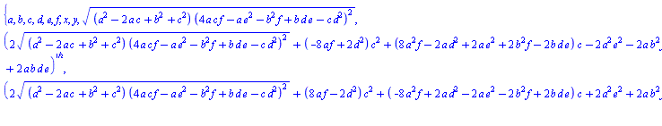

indets(eqn)
{a, b, c, d, e, f, x, y, ((a^2-2*a*c+b^2+c^2)*(4*a*c*f-a*e^2-b^2*f+b*d*e-c*d^2)^2)^(1/2), (2*((a^2-2*a*c+b^2+c^2)*(4*a*c*f-a*e^2-b^2*f+b*d*e-c*d^2)^2)^(1/2)+(-8*a*f+2*d^2)*c^2+(8*a^2*f-2*a*d^2+2*a*e^2+2*b^2*f-2*b*d*e)*c-2*a^2*e^2-2*a*b^2*f+2*a*b*d*e)^(1/2), (2*((a^2-2*a*c+b^2+c^2)*(4*a*c*f-a*e^2-b^2*f+b*d*e-c*d^2)^2)^(1/2)+(8*a*f-2*d^2)*c^2+(-8*a^2*f+2*a*d^2-2*a*e^2-2*b^2*f+2*b*d*e)*c+2*a^2*e^2+2*a*b^2*f-2*a*b*d*e)^(1/2), csgn((4*a*c*f-a*e^2-b^2*f+b*d*e-c*d^2)*(I*a-I*c-b))}
