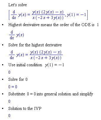

Question: ODESteps seems little confused on this ode.
How did Student:-ODEs:-ODESteps([ode,ic]); managed to get this zero solution to this ode? I can't follow the logic it did.
Any ideas what it is doing in the 4th step there?
"[[,,"Let's solve"],[,,[(ⅆ)/(ⅆx) y(x)=(y(x) (2 y(x)-x))/(x (-2 x+3 y(x))),y(1)=-1]],["•",,"Highest derivative means the order of the ODE is" 1],[,,(ⅆ)/(ⅆx) y(x)],["•",,"Solve for the highest derivative"],[,,(ⅆ)/(ⅆx) y(x)=(y(x) (2 y(x)-x))/(x (-2 x+3 y(x)))],["•",,"Use initial condition" y(1)=-1],[,,0],["•",,"Solve for" 0],[,,0=0],["•",,"Substitute" 0=0 "into general solution and simplify"],[,,0],["•",,"Solution to the IVP"],[,,0]]"
