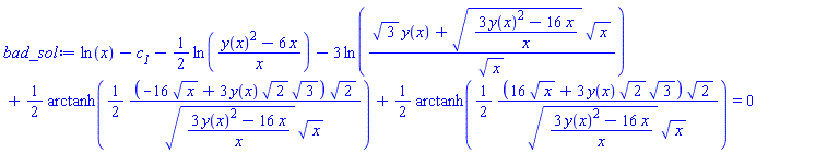

bad_sol:=ln(x) - c__1 - 1/2*ln((y(x)^2 - 6*x)/x) - 3*ln((sqrt(3)*y(x) + sqrt((3*y(x)^2 - 16*x)/x)*sqrt(x))/sqrt(x)) + 1/2*arctanh(1/2*(-16*sqrt(x) + 3*y(x)*sqrt(2)*sqrt(3))*sqrt(2)/(sqrt((3*y(x)^2 - 16*x)/x)*sqrt(x))) + 1/2*arctanh(1/2*(16*sqrt(x) + 3*y(x)*sqrt(2)*sqrt(3))*sqrt(2)/(sqrt((3*y(x)^2 - 16*x)/x)*sqrt(x))) = 0;
ln(x)-c__1-(1/2)*ln((y(x)^2-6*x)/x)-3*ln((3^(1/2)*y(x)+((3*y(x)^2-16*x)/x)^(1/2)*x^(1/2))/x^(1/2))+(1/2)*arctanh((1/2)*(-16*x^(1/2)+3*y(x)*2^(1/2)*3^(1/2))*2^(1/2)/(((3*y(x)^2-16*x)/x)^(1/2)*x^(1/2)))+(1/2)*arctanh((1/2)*(16*x^(1/2)+3*y(x)*2^(1/2)*3^(1/2))*2^(1/2)/(((3*y(x)^2-16*x)/x)^(1/2)*x^(1/2))) = 0

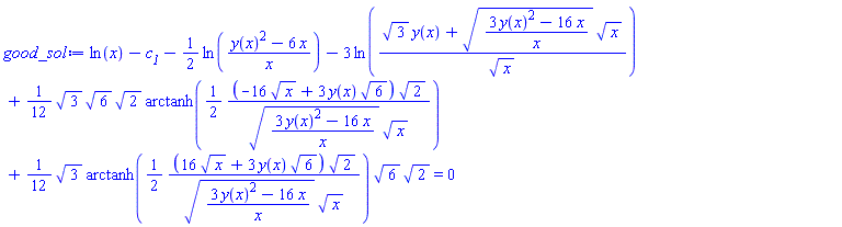

good_sol:=ln(x) - c__1 - 1/2*ln((y(x)^2 - 6*x)/x) - 3*ln((sqrt(3)*y(x) + sqrt(x)*sqrt((3*y(x)^2 - 16*x)/x))/sqrt(x)) + 1/12*sqrt(3)*sqrt(6)*sqrt(2)*arctanh(1/2*(-16*sqrt(x) + 3*y(x)*sqrt(6))*sqrt(2)/(sqrt(x)*sqrt((3*y(x)^2 - 16*x)/x))) + 1/12*sqrt(3)*arctanh(1/2*(16*sqrt(x) + 3*y(x)*sqrt(6))*sqrt(2)/(sqrt(x)*sqrt((3*y(x)^2 - 16*x)/x)))*sqrt(6)*sqrt(2) = 0;
ln(x)-c__1-(1/2)*ln((y(x)^2-6*x)/x)-3*ln((3^(1/2)*y(x)+((3*y(x)^2-16*x)/x)^(1/2)*x^(1/2))/x^(1/2))+(1/12)*3^(1/2)*6^(1/2)*2^(1/2)*arctanh((1/2)*(-16*x^(1/2)+3*y(x)*6^(1/2))*2^(1/2)/(((3*y(x)^2-16*x)/x)^(1/2)*x^(1/2)))+(1/12)*3^(1/2)*arctanh((1/2)*(16*x^(1/2)+3*y(x)*6^(1/2))*2^(1/2)/(((3*y(x)^2-16*x)/x)^(1/2)*x^(1/2)))*6^(1/2)*2^(1/2) = 0

odetest(good_sol,ode); #instant answer
odetest(bad_sol,ode); #hangs
Warning,  computation interrupted

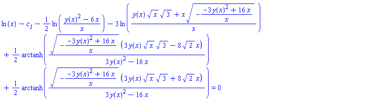

radnormal(bad_sol)
ln(x)-c__1-(1/2)*ln((y(x)^2-6*x)/x)-3*ln((y(x)*x^(1/2)*3^(1/2)+x*(-(-3*y(x)^2+16*x)/x)^(1/2))/x)+(1/2)*arctanh((-(-3*y(x)^2+16*x)/x)^(1/2)*(3*y(x)*x^(1/2)*3^(1/2)-8*2^(1/2)*x)/(3*y(x)^2-16*x))+(1/2)*arctanh((-(-3*y(x)^2+16*x)/x)^(1/2)*(3*y(x)*x^(1/2)*3^(1/2)+8*2^(1/2)*x)/(3*y(x)^2-16*x)) = 0
odetest(%,ode); #instant answer
