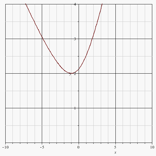

Here is an expression in x only. Plotting this it is clear it is never zero for any x value. Also asking Maple to solve this expression=0 for x, it finds no solution.  Yet, when I say coulditbe(e=0) it says true. also is(e=0) returns false.

plot(e,x=-10..10,y=0..4 );
