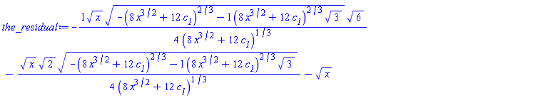

the_residual:=-1/4*I*x^(1/2)/(8*x^(3/2)+12*c__1)^(1/3)*(-(8*x^(3/2)+12*c__1)^(2/3)-I*(8*x^(3/2)+12*c__1)^(2/3)*3^(1/2))^(1/2)*6^(1/2)-1/4*x^(1/2)/(8*x^(3/2)+12*c__1)^(1/3)*2^(1/2)*(-(8*x^(3/2)+12*c__1)^(2/3)-I*(8*x^(3/2)+12*c__1)^(2/3)*3^(1/2))^(1/2)-x^(1/2);
