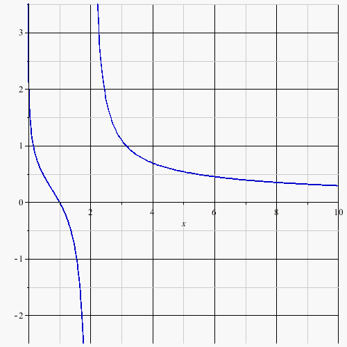

h := proc (x) options operator, arrow; ln(x)/(x-2) end proc
domain_ln := solve(x > 0, x)
RealRange(Open(0), infinity)
denom_undefined := solve(x-2 = 0, x)
2
domain := solve(`and`(x > 0, x <> 2), x)
solve({x > 0, x <> 2}, x)
{2 < x}, {0 < x, x < 2}
plot(h(x), x = 0 .. 10, discont = true, color = blue)
