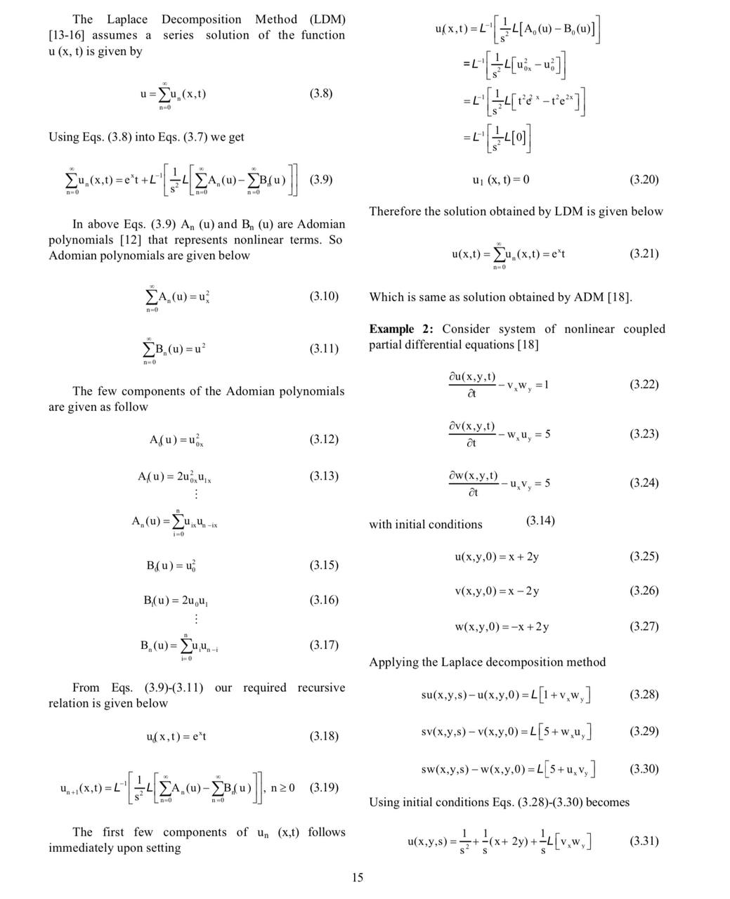

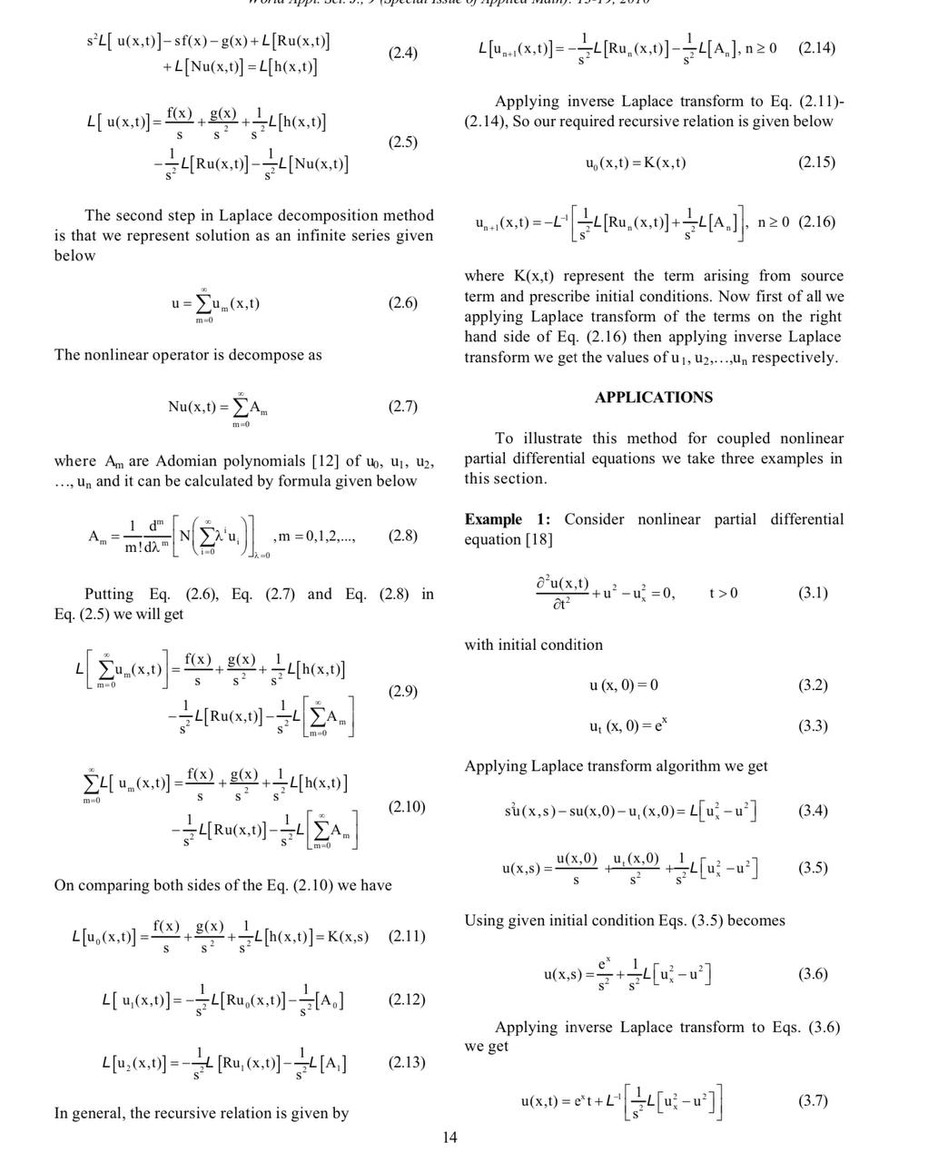

Question: How collect series solution of PDE?
this example is easiest one for getting solution but i can't collect each part and do like elite i can do each part seperatly but it take to much time i want collect solution and do by easier way if possible this is a laplace adomian decomposition methd which contain adomian polynomial too i want upgrade the code, can any one help the  process for get better vision of this topic
i do upload some picture and my mw. for more undrestanding
and please can any one explan why when i take laplace why is write D[2](u)(x, 0) must be D[1]?

"#` know we need find all term of  u[0]=exp(x)*t` #` u`[1]=-invlaplace(1/(s^(2))(`A__0`+`B__0`))  u[2]=-invlaplace(1/(s^(2))(`A__1`+`B__1`))   ans so on ... at end i want collect all of them and find final result even if is aproximate and want do test of pde too "
