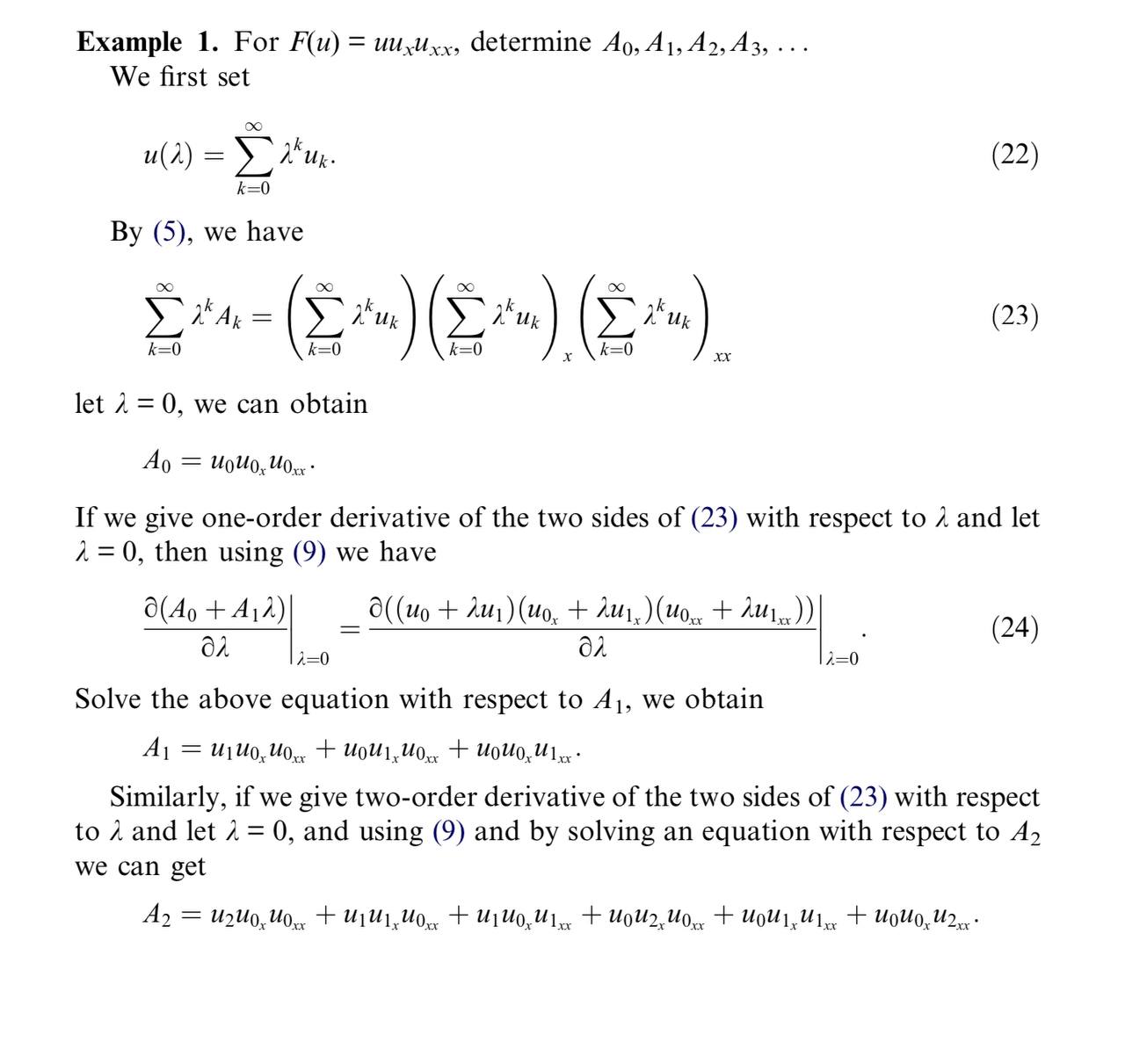

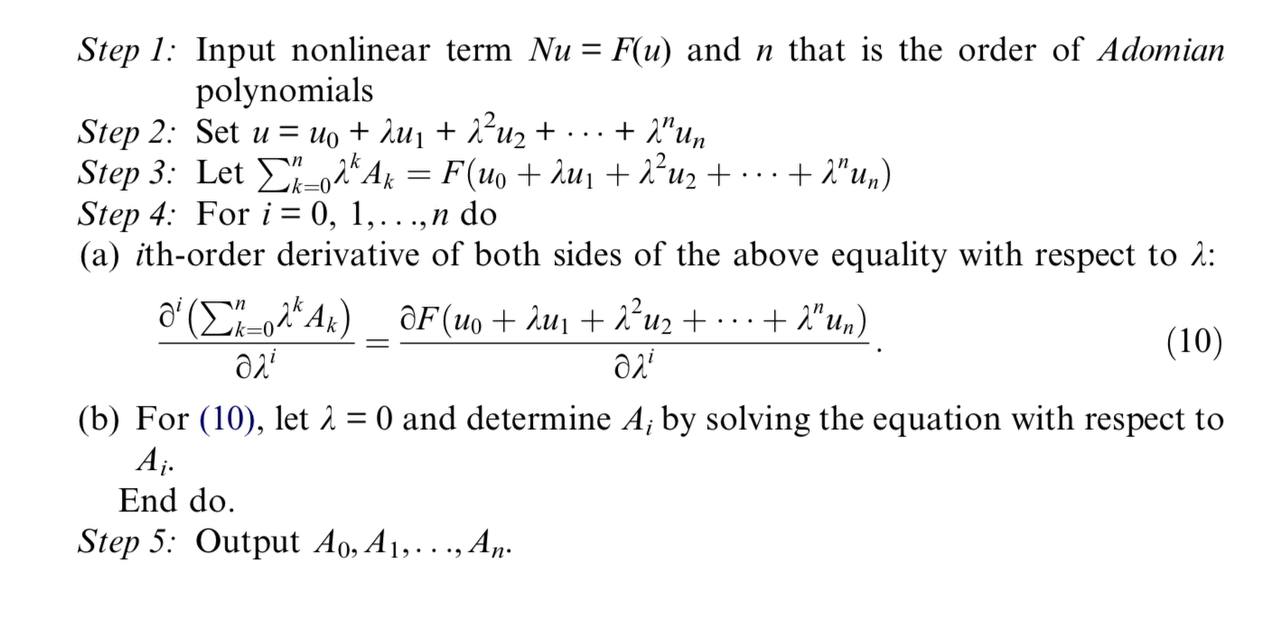

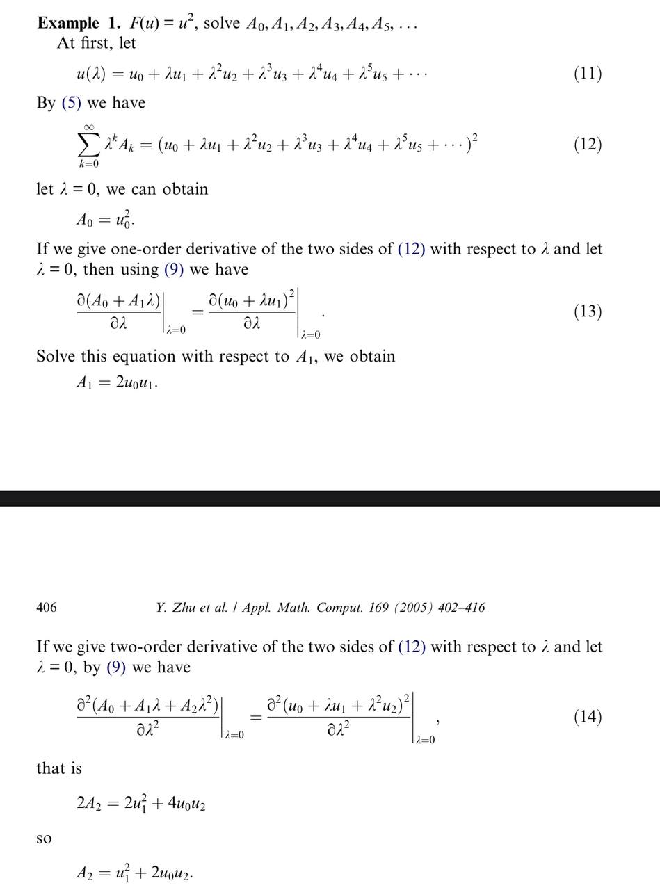

there is four formula for calculate them which i know them by name of author the first one is adomian second one is (BiazarShafiofAdomian) which one member of mableprimes write code for me,but i don't know how use for all kind function maybe in future i upload this program for fix this issue, the third one is by zhao which is i think i easy for calculate just  i need someone one to wite the program and do some test for some example i  upload some picture in case for getting algorithm to writting and have some example for testing  so  lets see who can do this algorithm is very usfule when we solve ODE or PDE by LDM, also last method is by taking integral have a good method, in this question this algorithm is zhao which is usfull one
