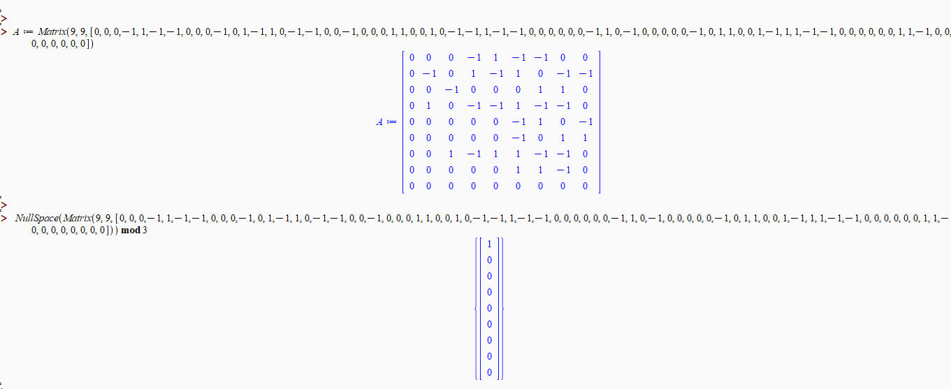

I tried to apply Berlekamp's theory to the polynomial X^9+X^6-X+1 in F3.
The matrix of the linear application whose kernel dimension is sought is:
 The dimension should be equal to 2 according to the theory since this polynomial decomposes into 2 irreducible polynomials.
However, the nullspace instruction of maple does not give a result consistent with the theory. Please help me find what is happening.
