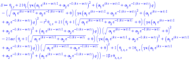

TT := Q = alpha[1]*exp(I*(k*x-t*w))+alpha[2]*exp(-I*(k*x-t*w))
Q = alpha[1]*exp((k*x-t*w)*I)+alpha[2]*exp(-I*(k*x-t*w))
S := eval(subs(TT, P))
diff(diff(theta(x, t), t), t)+(2*I)*(diff(theta(x, t), t))*(gamma*epsilon*(alpha[1]*exp((k*x-t*w)*I)+alpha[2]*exp(-I*(k*x-t*w)))^2+(alpha[1]*exp((k*x-t*w)*I)+alpha[2]*exp(-I*(k*x-t*w)))*q)-((alpha[1]*exp((k*x-t*w)*I)+alpha[2]*exp(-I*(k*x-t*w)))^(1/2)+theta(x, t))*(gamma*epsilon*(alpha[1]*exp((k*x-t*w)*I)+alpha[2]*exp(-I*(k*x-t*w)))^2+(alpha[1]*exp((k*x-t*w)*I)+alpha[2]*exp(-I*(k*x-t*w)))*q)^2-s^2*(diff(diff(theta(x, t), x), x))+(2*I)*(diff(theta(x, t), t)+I*((alpha[1]*exp((k*x-t*w)*I)+alpha[2]*exp(-I*(k*x-t*w)))^(1/2)+theta(x, t))*(gamma*epsilon*(alpha[1]*exp((k*x-t*w)*I)+alpha[2]*exp(-I*(k*x-t*w)))^2+(alpha[1]*exp((k*x-t*w)*I)+alpha[2]*exp(-I*(k*x-t*w)))*q))*((alpha[1]*exp((k*x-t*w)*I)+alpha[2]*exp(-I*(k*x-t*w)))^(1/2)+theta(x, t))^2-(2*I)*alpha*s*(diff(theta(x, t), t)+I*((alpha[1]*exp((k*x-t*w)*I)+alpha[2]*exp(-I*(k*x-t*w)))^(1/2)+theta(x, t))*(gamma*epsilon*(alpha[1]*exp((k*x-t*w)*I)+alpha[2]*exp(-I*(k*x-t*w)))^2+(alpha[1]*exp((k*x-t*w)*I)+alpha[2]*exp(-I*(k*x-t*w)))*q))*((alpha[1]*exp((k*x-t*w)*I)+alpha[2]*exp(-I*(k*x-t*w)))^(1/2)+theta(x, t))^2+I*(diff(diff(diff(theta(x, t), t), x), x)+I*(diff(diff(theta(x, t), x), x))*(gamma*epsilon*(alpha[1]*exp((k*x-t*w)*I)+alpha[2]*exp(-I*(k*x-t*w)))^2+(alpha[1]*exp((k*x-t*w)*I)+alpha[2]*exp(-I*(k*x-t*w)))*q))-I*beta*s*(diff(diff(diff(theta(x, t), x), x), x))
