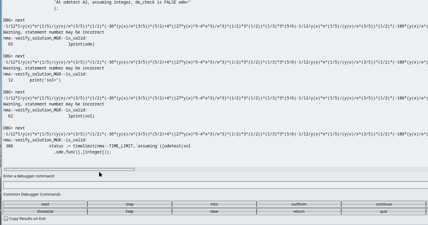

Sometimes I get server crash and sometimes I get message  I never seen before  invalid nesting of _Inert_HASH structure and it always happens on the call to the second line in `assuming/restore_previous_state`; shown below.  The crash says stack limit reached.
I have 92 GB RAM.
it happens on the command
I could only for now make a small movie. with few debug commands I did.
If someone can suggest what other debug commands I could do to help find why this happen, I will try them. Maybe look at stack or examine some other maple internal data.
Here is the movie (you can put the mouse on the image and right click->open in new tab. To make it larger and easier to see)
It happen when I have odetest inside try/catch. And in the catch, call `assuming/restore_previous_state`;
