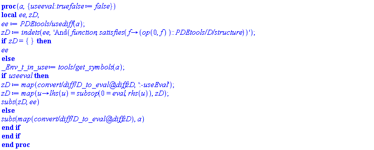

print(`convert/diff`);
proc (a, { useeval::truefalse := false }) local ee, zD; ee := `PDEtools/usediff`(a); zD := indets(ee, 'And(function, satisfies(proc (f) options operator, arrow; (op(0, f))::`PDEtools/D/structure` end proc))'); if zD = {} then ee else _Env_t_in_use := `tools/get_symbols`(a); if useeval then zD := map(`convert/diff/D_to_eval@diff`, zD, ':-useEval'); zD := map(proc (u) options operator, arrow; lhs(u) = subsop(0 = eval, rhs(u)) end proc, zD); subs(zD, ee) else subs(map(`convert/diff/D_to_eval@diff`, zD), a) end if end if end proc
proc () local ans; ans := usepdiff(args); if has([ans], 'D') then ans := Physics:-OriginalValue["convert/diff"](ans, args[2 .. -1]) end if; ans end proc
