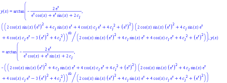

y(x) = arctan(-2*exp(x)/(exp(x)*cos(x)+exp(x)*sin(x)+2*c__1), ((2*cos(x)*sin(x)*(exp(x))^2+4*c__1*sin(x)*exp(x)+4*cos(x)*c__1*exp(x)+4*c__1^2+(exp(x))^2)*(2*cos(x)*sin(x)*(exp(x))^2+4*c__1*sin(x)*exp(x)+4*cos(x)*c__1*exp(x)-3*(exp(x))^2+4*c__1^2))^(1/2)/(2*cos(x)*sin(x)*(exp(x))^2+4*c__1*sin(x)*exp(x)+4*cos(x)*c__1*exp(x)+4*c__1^2+(exp(x))^2)), y(x) = arctan(-2*exp(x)/(exp(x)*cos(x)+exp(x)*sin(x)+2*c__1), -((2*cos(x)*sin(x)*(exp(x))^2+4*c__1*sin(x)*exp(x)+4*cos(x)*c__1*exp(x)+4*c__1^2+(exp(x))^2)*(2*cos(x)*sin(x)*(exp(x))^2+4*c__1*sin(x)*exp(x)+4*cos(x)*c__1*exp(x)-3*(exp(x))^2+4*c__1^2))^(1/2)/(2*cos(x)*sin(x)*(exp(x))^2+4*c__1*sin(x)*exp(x)+4*cos(x)*c__1*exp(x)+4*c__1^2+(exp(x))^2))
