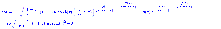

Could someone suggest a way to help dsolve be able to obtain this solution to this complicated first order ode? In V 2025.2 it is not able to solve it as is
ode:=-x*sqrt((1 - x)/(x + 1))*(x + 1)*arcsech(x)*diff(y(x), x)*exp(y(x)/arcsech(x) + exp(y(x)/arcsech(x))) - y(x)*exp(y(x)/arcsech(x) + exp(y(x)/arcsech(x))) + 2*x*sqrt((1 - x)/(x + 1))*(x + 1)*arcsech(x)^2 = 0;
