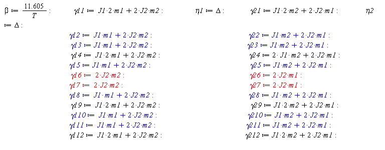

beta := 11.605/T; gamma11 := 2*J1*m1+2*J2*m2; eta1 := Delta; gamma21 := 2*J1*m2+2*J2*m1; eta2 := Delta; gamma12 := J1*m1+2*J2*m2; gamma22 := J1*m2+2*J2*m1; gamma13 := J1*m1+2*J2*m2; gamma23 := J1*m2+2*J2*m1; gamma14 := 2*J1*m1+2*J2*m2; gamma24 := 2*J1*m2+2*J2*m1; gamma15 := J1*m1+2*J2*m2; gamma25 := J1*m2+2*J2*m1; gamma16 := 2*J2*m2; gamma26 := 2*J2*m1; gamma17 := 2*J2*m2; gamma27 := 2*J2*m1; gamma18 := J1*m1+2*J2*m2; gamma28 := J1*m2+2*J2*m1; gamma19 := 2*J1*m1+2*J2*m2; gamma29 := 2*J1*m2+2*J2*m1; gamma110 := J1*m1+2*J2*m2; gamma210 := J1*m2+2*J2*m1; gamma111 := J1*m1+2*J2*m2; gamma211 := J1*m2+2*J2*m1; gamma112 := 2*J1*m1+2*J2*m2; gamma212 := 2*J1*m2+2*J2*m1
