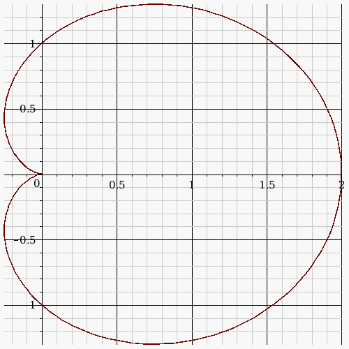

Plot the cardioids  1+`&+-`(cos*t) in polar coordinates:
pic1 := plot(1-cos(t), t=0..2*Pi, coords=polar);

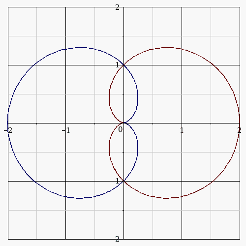

pic2 := plot(1+cos(t), t=0..2*Pi, coords=polar);

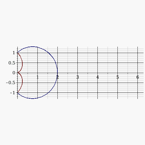

When combining the plots, display() inherits the plotting range from the previous
plots, incorrecting taking it to be 0 .. 2*Pi
plots:-display(pic1, pic2, scaling=constrained);

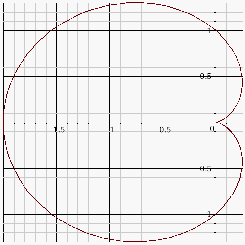

To get the correct plot, we need to override the range determined by display():
plots:-display(pic1, pic2, scaling=constrained, view=[-2..2,-2..2]);
