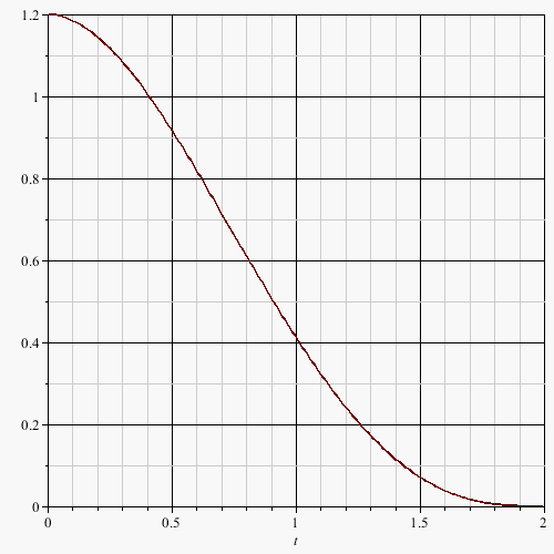

f := proc (t) options operator, arrow; piecewise(t <= 0, 0, t <= 2, 6/5-(3/2)*t^2+(3/4)*t^3-(3/80)*t^5, 2 <= t, 0) end proc
plot(f(t), t = 0 .. 2)

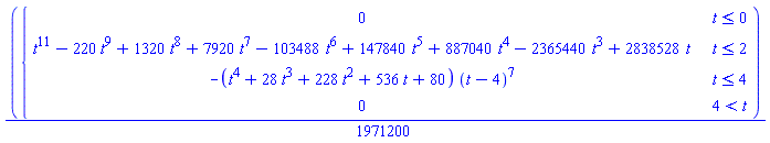

simplify(int(f(tau)*f(t-tau), tau = -infinity .. infinity))
(1/1971200)*piecewise(t <= 0, 0, t <= 2, t^11-220*t^9+1320*t^8+7920*t^7-103488*t^6+147840*t^5+887040*t^4-2365440*t^3+2838528*t, t <= 4, -(t^4+28*t^3+228*t^2+536*t+80)*(t-4)^7, 4 < t, 0)

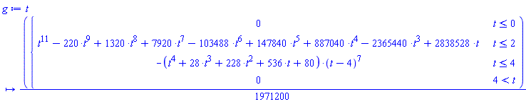

g := unapply(simplify(int(f(tau)*f(t-tau), tau = -infinity .. infinity)), t)
proc (t) options operator, arrow; (1/1971200)*piecewise(t <= 0, 0, t <= 2, t^11-220*t^9+1320*t^8+7920*t^7-103488*t^6+147840*t^5+887040*t^4-2365440*t^3+2838528*t, t <= 4, -(t^4+28*t^3+228*t^2+536*t+80)*(t-4)^7, 4 < t, 0) end proc

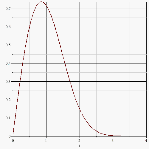

plot(g(t), t = 0 .. 4)
int(g(t), t = 0 .. 4)
evalf(int(g(t), t = 0 .. 4/sqrt(3)))
.98591299
evalf(int(g(t), t = 4/sqrt(3) .. 4))
0.1408701e-1
