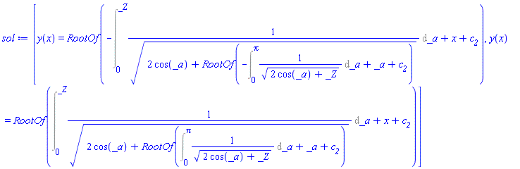

ode := diff(diff(y(x), x), x)+sin(y(x)) = 0; IC := y(infinity) = Pi; sol := [dsolve([ode, IC])]
y(infinity) = Pi
[y(x) = RootOf(-(Int(1/(2*cos(_a)+RootOf(-(Int(1/(2*cos(_a)+_Z)^(1/2), _a = 0 .. Pi))+_a+c__2))^(1/2), _a = 0 .. _Z))+x+c__2), y(x) = RootOf(Int(1/(2*cos(_a)+RootOf(Int(1/(2*cos(_a)+_Z)^(1/2), _a = 0 .. Pi)+_a+c__2))^(1/2), _a = 0 .. _Z)+x+c__2)]

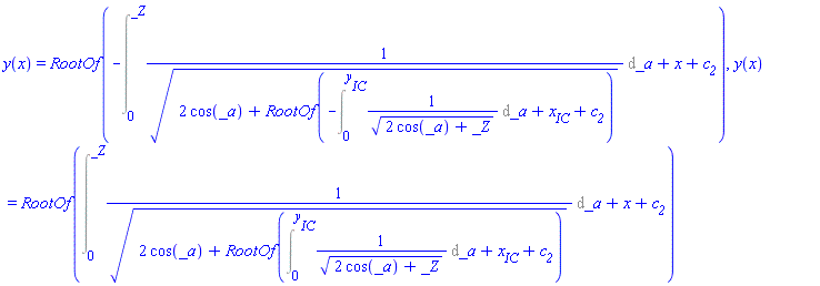

dsolve([ode, y(x__IC) = y__IC])
y(x) = RootOf(-(Int(1/(2*cos(_a)+RootOf(-(Int(1/(2*cos(_a)+_Z)^(1/2), _a = 0 .. y__IC))+x__IC+c__2))^(1/2), _a = 0 .. _Z))+x+c__2), y(x) = RootOf(Int(1/(2*cos(_a)+RootOf(Int(1/(2*cos(_a)+_Z)^(1/2), _a = 0 .. y__IC)+x__IC+c__2))^(1/2), _a = 0 .. _Z)+x+c__2)

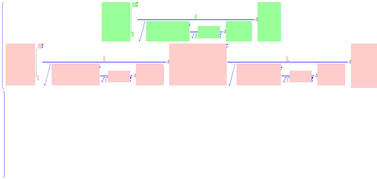

ExpressionTools:-Compare(sol[1], [y(x) = RootOf(-(Int(1/(2*cos(_a)+RootOf(-(Int(1/(2*cos(_a)+_Z)^(1/2), _a = 0 .. y__IC))+x__IC+c__2))^(1/2), _a = 0 .. _Z))+x+c__2), y(x) = RootOf(Int(1/(2*cos(_a)+RootOf(Int(1/(2*cos(_a)+_Z)^(1/2), _a = 0 .. y__IC)+x__IC+c__2))^(1/2), _a = 0 .. _Z)+x+c__2)][1])
"([[y(x)=RootOf(-(∫)[0]^_Z1/(sqrt(2 cos(_a)+RootOf(-(∫)[0]^Pi1/(sqrt(2 cos(_a)+_Z)) ⅆ_a+_a+`c__2`))) ⅆ_a+x+`c__2`)],[[y(x)=RootOf(-(∫)[0]^_Z1/(sqrt(2 cos(_a)+RootOf(-(∫)[0]^`y__IC`1/(sqrt(2 cos(_a)+_Z)) ⅆ_a+`x__IC`+`c__2`))) ⅆ_a+x+`c__2`),y(x)=RootOf((∫)[0]^_Z1/(sqrt(2 cos(_a)+RootOf((∫)[0]^`y__IC`1/(sqrt(2 cos(_a)+_Z)) ⅆ_a+`x__IC`+`c__2`))) ⅆ_a+x+`c__2`)][1]]])"

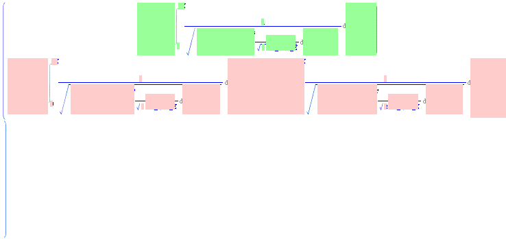

ExpressionTools:-Compare(sol[1], (y(x) = RootOf(-(Int(1/(2*cos(_a)+RootOf(-(Int(1/(2*cos(_a)+_Z)^(1/2), _a = 0 .. y__IC))+x__IC+c__2))^(1/2), _a = 0 .. _Z))+x+c__2), y(x) = RootOf(Int(1/(2*cos(_a)+RootOf(Int(1/(2*cos(_a)+_Z)^(1/2), _a = 0 .. y__IC)+x__IC+c__2))^(1/2), _a = 0 .. _Z)+x+c__2))[1])
"([[y(x)=RootOf(-(∫)[0]^_Z1/(sqrt(2 cos(_a)+RootOf(-(∫)[0]^Pi1/(sqrt(2 cos(_a)+_Z)) ⅆ_a+_a+`c__2`))) ⅆ_a+x+`c__2`)],[(y(x)=RootOf(-(∫)[0]^_Z1/(sqrt(2 cos(_a)+RootOf(-(∫)[0]^`y__IC`1/(sqrt(2 cos(_a)+_Z)) ⅆ_a+`x__IC`+`c__2`))) ⅆ_a+x+`c__2`),y(x)=RootOf((∫)[0]^_Z1/(sqrt(2 cos(_a)+RootOf((∫)[0]^`y__IC`1/(sqrt(2 cos(_a)+_Z)) ⅆ_a+`x__IC`+`c__2`))) ⅆ_a+x+`c__2`))[1]]])"

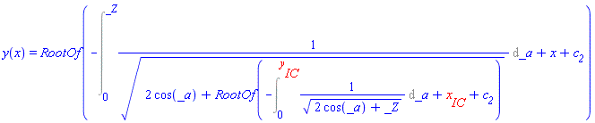

(y(x) = RootOf(-(Int(1/(2*cos(_a)+RootOf(-(Int(1/(2*cos(_a)+_Z)^(1/2), _a = 0 .. y__IC))+x__IC+c__2))^(1/2), _a = 0 .. _Z))+x+c__2), y(x) = RootOf(Int(1/(2*cos(_a)+RootOf(Int(1/(2*cos(_a)+_Z)^(1/2), _a = 0 .. y__IC)+x__IC+c__2))^(1/2), _a = 0 .. _Z)+x+c__2))[1]; ExpressionTools:-Compare(sol[1], %)
y(x) = RootOf(-(Int(1/sqrt(2*cos(_a)+RootOf(-(Int(1/sqrt(2*cos(_a)+_Z), _a = 0 .. y__IC))+x__IC+c__2)), _a = 0 .. _Z))+x+c__2)
