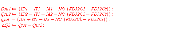

while it is obvious Qtot>Qsu2 MAPLE calculates the  difference between then DeltaQ2=Qtot-Qsu2 as NEGATIVE and of the order of 1014!!!!!!! (DeltaQ2=-4.27e14!!!!!!!!!!)

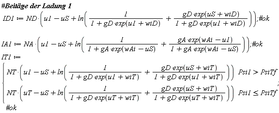

I conducted the same calculation seperately (see below: seperate calculation) i.e. without do loops and i noticed that the same calculation when is done without loops delivers different values for the IDS,ID1,ID2,IAS,IA1,IA2,ITS,IT1,IT2 and subsequently different values for the sums Qtot, Qsu1, Qsu2 (comparison of the values is found in attached maple sheets)
At the end the differnce DeltaQ2 is correctly calculated by the seperate calculation while my programm -no matter what i tried- calculates Delta Q2 as negative (DeltaQ2 =-4.27e14 !!!!!!!!!) and in any case the Programm calculates different values for all the with red color highlighted elements.
Why maple calculates differently things in the do loop than in the seperate calculation???????

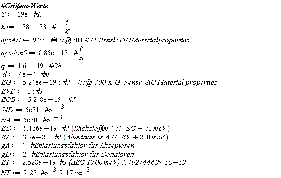

T := 298:
d := 0.4e-3:
0.1256637062e-6

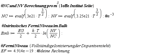

NC := evalf(0.3e22*T^(3/2));
0.1543283279e26
0.1671890219e26

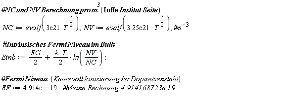

PsiST := ImportMatrix(
Matrix(%id = 171061860)
PsiS := PsiST[1, 1];
.1

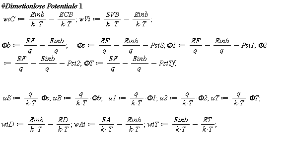

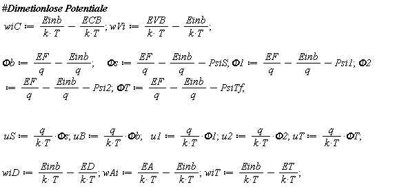

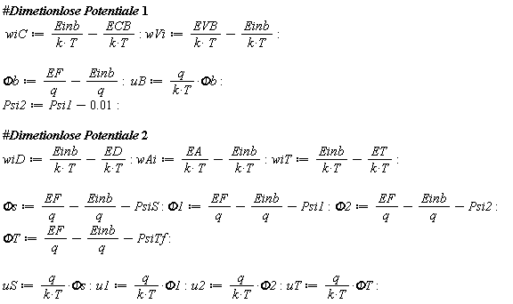

wiC := Einb/(k*T)-ECB/(k*T);
-63.76700127
-63.84704403
1.430221351
1.330221351
1.420221351
1.430221351
1.400221351
51.75455116
55.64522327
55.25615606
55.64522327
54.47802164
-61.04353077
-56.06569980
2.37442463

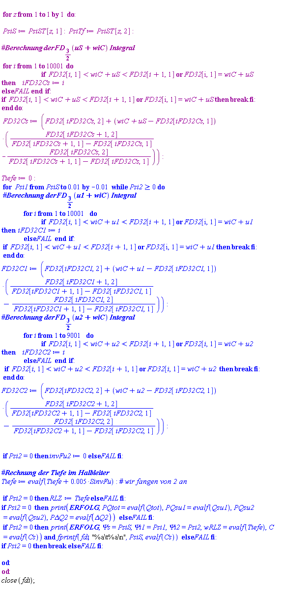

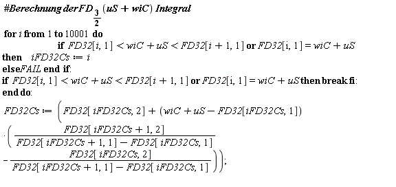

FD32 := ImportMatrix(
Matrix(%id = 150549700)

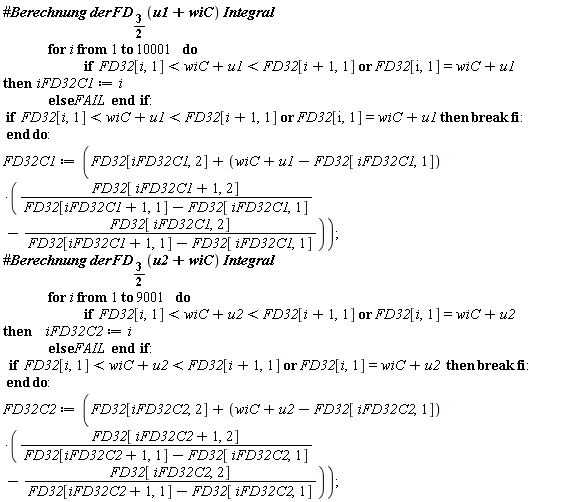

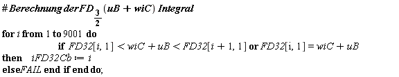

for i to 9001 do if `or`(FD32[i, 1] < wiC+uB and wiC+uB < FD32[i+1, 1], FD32[i, 1] = wiC+uB) then iFD32Cb := i else FAIL end if end do;
FD32Cb := FD32[iFD32Cb, 2]+(wiC+uB-FD32[iFD32Cb, 1])*(FD32[iFD32Cb+1, 2]-FD32[iFD32Cb, 2])/(FD32[iFD32Cb+1, 1]-FD32[iFD32Cb, 1]);
0.2972328603e-3
for i to 10001 do if `or`(FD32[i, 1] < wiC+uS and wiC+uS < FD32[i+1, 1], FD32[i, 1] = wiC+uS) then iFD32Cs := i else FAIL end if; if `or`(FD32[i, 1] < wiC+uS and wiC+uS < FD32[i+1, 1], FD32[i, 1] = wiC+uS) then break end if end do:
0.6071414207e-5
for i to 10001 do if `or`(FD32[i, 1] < wiC+u1 and wiC+u1 < FD32[i+1, 1], FD32[i, 1] = wiC+u1) then iFD32C1 := i else FAIL end if; if `or`(FD32[i, 1] < wiC+u1 and wiC+u1 < FD32[i+1, 1], FD32[i, 1] = wiC+u1) then break end if end do:
0.2013612589e-3
0.2972328603e-3

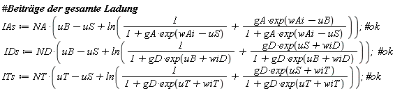

IAs := NA*(uB-uS+ln(1/(1+gA*exp(wAi-uS))+gA*exp(wAi-uB)/(1+gA*exp(wAi-uS))));

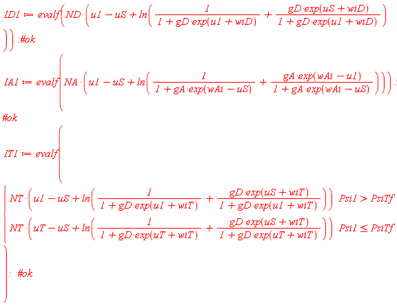

ID1 := ND*(u1-uS+ln(1/(1+gD*exp(u1+wiD))+gD*exp(uS+wiD)/(1+gD*exp(u1+wiD)))); IA1 := NA*(u1-uS+ln(1/(1+gA*exp(wAi-uS))+gA*exp(wAi-u1)/(1+gA*exp(wAi-uS)))); IT1 := piecewise(Psi1 > PsiTf, NT*(u1-uS+ln(1/(1+gD*exp(u1+wiT))+gD*exp(uS+wiT)/(1+gD*exp(u1+wiT)))), Psi1 <= PsiTf, NT*(uT-uS+ln(1/(1+gD*exp(uT+wiT))+gD*exp(uS+wiT)/(1+gD*exp(uT+wiT)))))
0.1747838220e23
0.1750802450e22
0.

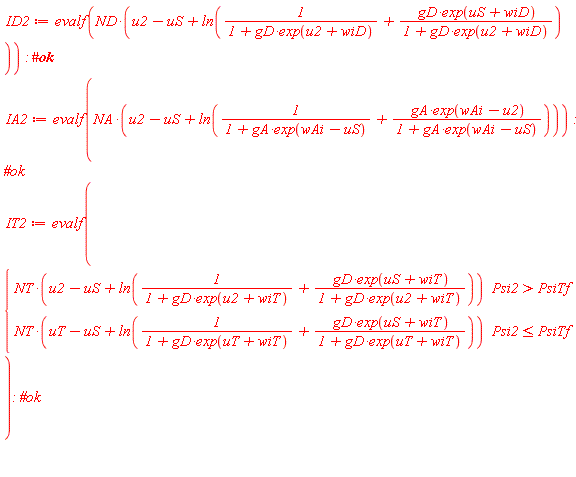

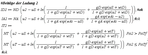

ID2 := ND*(u2-uS+ln(1/(1+gD*exp(u2+wiD))+gD*exp(uS+wiD)/(1+gD*exp(u2+wiD)))); IA2 := NA*(u2-uS+ln(1/(1+gA*exp(wAi-uS))+gA*exp(wAi-u2)/(1+gA*exp(wAi-uS)))); IT2 := piecewise(Psi2 > PsiTf, NT*(u2-uS+ln(1/(1+gD*exp(u2+wiT))+gD*exp(uS+wiT)/(1+gD*exp(u2+wiT)))), Psi2 <= PsiTf, NT*(uT-uS+ln(1/(1+gD*exp(uT+wiT))+gD*exp(uS+wiT)/(1+gD*exp(uT+wiT)))))
0.1940924598e23
0.1945336055e22
0.

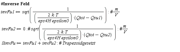

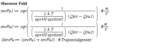

invFu1 := sqrt(1/(2*k*T*(Qtot-Qsu1)/(eps4H*epsilon0))):
`ΔwRLZ` := 0.5e-2*SinvFu;
0.3197719593e-7

wiC := Einb/(k*T)-ECB/(k*T); wVi := EVB/(k*T)-Einb/(k*T); `Φb` := EF/q-Einb/q; uB := q*`Φb`/(k*T); Psi2 := Psi1-0.1e-1; wiD := Einb/(k*T)-ED/(k*T); wAi := EA/(k*T)-Einb/(k*T); wiT := Einb/(k*T)-ET/(k*T); `Φs` := EF/q-Einb/q-PsiS; Phi1 := EF/q-Einb/q-Psi1; Phi2 := EF/q-Einb/q-Psi2; `ΦT` := EF/q-Einb/q-PsiTf; uS := q*`Φs`/(k*T); u1 := q*Phi1/(k*T); u2 := q*Phi2/(k*T); uT := q*`ΦT`/(k*T)

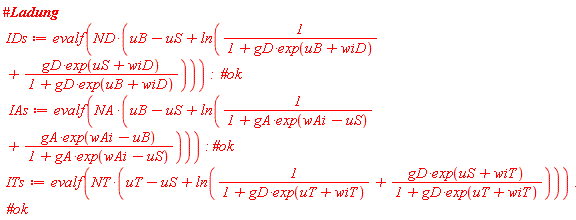

IDs := evalf(ND*(uB-uS+ln(1/(1+gD*exp(uB+wiD))+gD*exp(uS+wiD)/(1+gD*exp(uB+wiD))))):
ID1 := evalf(ND*(u1-uS+ln(1/(1+gD*exp(u1+wiD))+gD*exp(uS+wiD)/(1+gD*exp(u1+wiD))))); IA1 := evalf(NA*(u1-uS+ln(1/(1+gA*exp(wAi-uS))+gA*exp(wAi-u1)/(1+gA*exp(wAi-uS))))); IT1 := evalf(piecewise(Psi1 > PsiTf, NT*(u1-uS+ln(1/(1+gD*exp(u1+wiT))+gD*exp(uS+wiT)/(1+gD*exp(u1+wiT)))), Psi1 <= PsiTf, NT*(uT-uS+ln(1/(1+gD*exp(uT+wiT))+gD*exp(uS+wiT)/(1+gD*exp(uT+wiT))))))
ID2 := evalf(ND*(u2-uS+ln(1/(1+gD*exp(u2+wiD))+gD*exp(uS+wiD)/(1+gD*exp(u2+wiD))))); IA2 := evalf(NA*(u2-uS+ln(1/(1+gA*exp(wAi-uS))+gA*exp(wAi-u2)/(1+gA*exp(wAi-uS))))); IT2 := evalf(piecewise(Psi2 > PsiTf, NT*(u2-uS+ln(1/(1+gD*exp(u2+wiT))+gD*exp(uS+wiT)/(1+gD*exp(u2+wiT)))), Psi2 <= PsiTf, NT*(uT-uS+ln(1/(1+gD*exp(uT+wiT))+gD*exp(uS+wiT)/(1+gD*exp(uT+wiT))))))
Qsu1 := ID1+IT1-IA1-NC*(FD32C1-FD32Cs); Qsu2 := ID2+IT2-IA2-NC*(FD32C2-FD32Cs); Qtot := IDs+ITs-IAs-NC*(FD32Cb-FD32Cs); `ΔQ2` := Qtot-Qsu2
fdi := open(
for z to 1 do PsiS := PsiST[z, 1]; PsiTf := PsiST[z, 2]; for i to 10001 do if `or`(FD32[i, 1] < wiC+uS and wiC+uS < FD32[i+1, 1], FD32[i, 1] = wiC+uS) then iFD32Cs := i else FAIL end if; if `or`(FD32[i, 1] < wiC+uS and wiC+uS < FD32[i+1, 1], FD32[i, 1] = wiC+uS) then break end if end do; FD32Cs := FD32[iFD32Cs, 2]+(wiC+uS-FD32[iFD32Cs, 1])*(FD32[iFD32Cs+1, 2]/(FD32[iFD32Cs+1, 1]-FD32[iFD32Cs, 1])-FD32[iFD32Cs, 2]/(FD32[iFD32Cs+1, 1]-FD32[iFD32Cs, 1])); Tiefe := 0; for Psi1 from PsiS by -0.1e-1 to 0.1e-1 while Psi2 >= 0 do for i to 10001 do if `or`(FD32[i, 1] < wiC+u1 and wiC+u1 < FD32[i+1, 1], FD32[i, 1] = wiC+u1) then iFD32C1 := i else FAIL end if; if `or`(FD32[i, 1] < wiC+u1 and wiC+u1 < FD32[i+1, 1], FD32[i, 1] = wiC+u1) then break end if end do; FD32C1 := FD32[iFD32C1, 2]+(wiC+u1-FD32[iFD32C1, 1])*(FD32[iFD32C1+1, 2]/(FD32[iFD32C1+1, 1]-FD32[iFD32C1, 1])-FD32[iFD32C1, 2]/(FD32[iFD32C1+1, 1]-FD32[iFD32C1, 1])); for i to 9001 do if `or`(FD32[i, 1] < wiC+u2 and wiC+u2 < FD32[i+1, 1], FD32[i, 1] = wiC+u2) then iFD32C2 := i else FAIL end if; if `or`(FD32[i, 1] < wiC+u2 and wiC+u2 < FD32[i+1, 1], FD32[i, 1] = wiC+u2) then break end if end do; FD32C2 := FD32[iFD32C2, 2]+(wiC+u2-FD32[iFD32C2, 1])*(FD32[iFD32C2+1, 2]/(FD32[iFD32C2+1, 1]-FD32[iFD32C2, 1])-FD32[iFD32C2, 2]/(FD32[iFD32C2+1, 1]-FD32[iFD32C2, 1])); if Psi2 = 0 then invFu2 := 0 else FAIL end if; Tiefe := evalf(Tiefe+0.5e-2*SinvFu); if Psi2 = 0 then RLZ := Tiefe else FAIL end if; if Psi2 = 0 then print(ERFOLG, PQtot = evalf(Qtot), PQsu1 = evalf(Qsu1), PQsu2 = evalf(Qsu2), `PΔQ2` = evalf(`ΔQ2`)) else FAIL end if; if Psi2 = 0 then `and`(print(ERFOLG, `Ψs` = PsiS, `Ψi1` = Psi1, `Ψi2` = Psi2, wRLZ = evalf(Tiefe), C = evalf(Cs)), fprintf(fdi,
ERFOLG, PQtot = 0.1297046409e23, PQsu1 = 0.1271370424e23, PQsu2 = 0.1297046402e23, `PΔQ2` = -0.427e15
ERFOLG, `Ψs` = .1, `Ψi1` = 0.1e-1, `Ψi2` = 0., wRLZ = 0.2005595218e-6+0.2479647448e-4*I, C = 0.8850706929e-3-.1094270302*I

IDs;
0.1940924600e23
0.1747838221e23
0.1940924599e23
IAs;
0.1945336057e22
0.1750802451e22
0.1945336056e22
ITs;
0.
0.
0.
