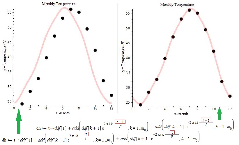

Question: Adjust using FFT
 What justifies the t-1; to achieve this result?

dh := proc (t) options operator, arrow; ddf[1]+add(ddf[k+1]*exp((2*I)*Pi*k*(t-1)/P), k = 1 .. m0)+add(conjugate(ddf[k+1])*exp(-(2*I)*Pi*k*(t-1)/P), k = 1 .. m0) end proc;
p2 := plot(dh(t), t = 0 .. P, color = red, thickness = 5, linestyle = 1, transparency = .8);
plots[display](p1, p2);
