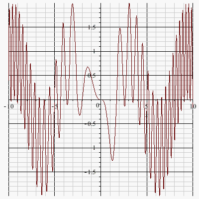

plot(cos(x^2+x)+cos(x+2*Pi*(1/3))+cos(x+4*Pi*(1/3)), x = -10 .. 10)
