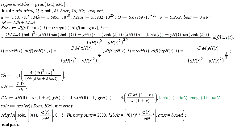

I have an error in my code. I don't know where it came from. Earlier today I loaded this and it worked fine and now an error comes up. Any help is greatly appreciated! Thank you in advance!

HyperionOrbit := proc (`θIC`, `ωIC`) local a, Mh, Msat, G, e, beta, M, Eqns, Th, ICs, soln, `ωH`; a := 1.501*10^9; Mh := 5.5855*10^18; Msat := 5.6832*10^26; G := 6.67259/10^11; e := .232; beta := .89; M := Mh+Msat; Eqns := diff(theta(t), t) = omega(t), diff(omega(t), t) = -G*Msat*beta^2*(xH(t)*sin(theta(t))-yH(t)*cos(theta(t)))*(xH(t)*cos(theta(t))+yH(t)*sin(theta(t)))/(xH(t)^2+yH(t)^2)^2.5, diff(xH(t), t) = vxH(t), diff(vxH(t), t) = -G*M*xH(t)/(xH(t)^2+yH(t)^2)^(3/2), diff(yH(t), t) = vyH(t), diff(vyH(t), t) = -G*M*yH(t)/(xH(t)^2+yH(t)^2)^(3/2); Th := sqrt(4*Pi^2*a^3/(G*(Mh+Msat))); `ωH` := 2*Pi/Th; ICs := xH(0) = a*(1+e), yH(0) = 0, vxH(0) = 0, vyH(0) = sqrt(G*M*(1-e)/(a*(1+e))), theta(0) = `θIC`, omega(0) = `ωIC`; soln := dsolve({Eqns, ICs}, numeric); odeplot(soln, [theta(t), omega(t)/`ωH`], 0 .. 5*Th, numpoints = 2000, labels = ["θ(t)","ω(t)/ωH"], axes = boxed) end proc
HyperionOrbit(.5, 1.8*`ωH`)
Warning, The use of global variables in numerical ODE problems is deprecated, and will be removed in a future release. Use the 'parameters' argument instead (see ?dsolve,numeric,parameters)
Error, (in dsolve/numeric/SC/IVPpoints) unable to store '11.3097335529232/Th' when datatype=float[8]
